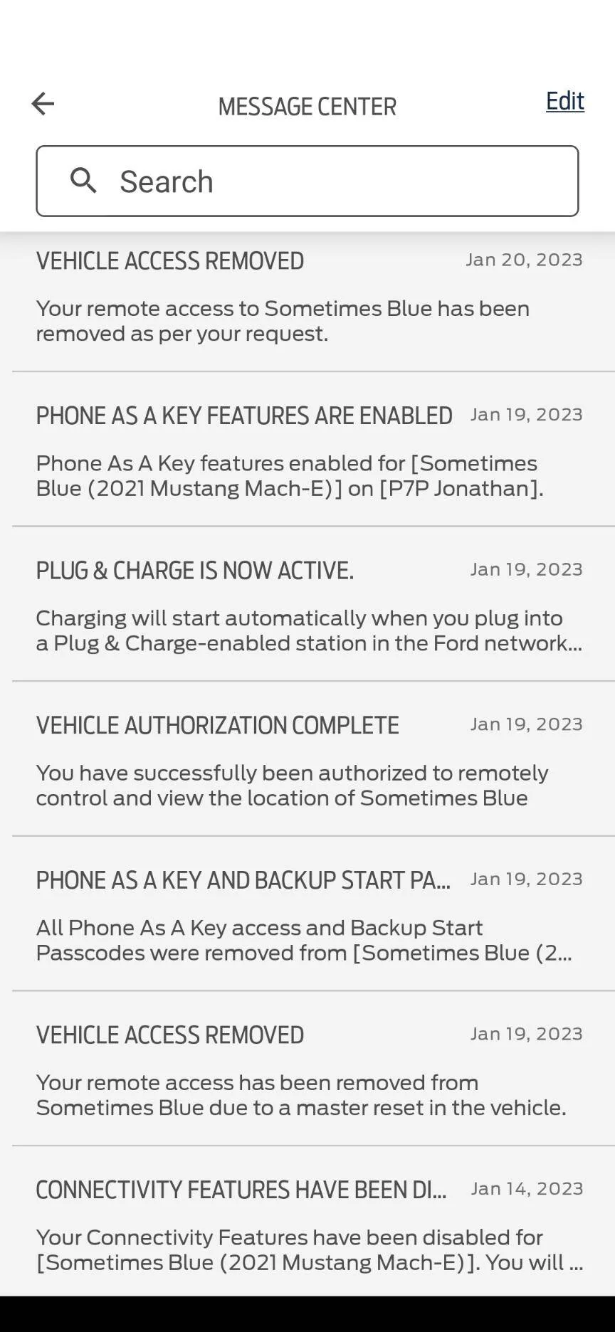

When I did master resets on my vehicle, I noticed that the notifications aren't always paired up equally. Like, you get a notification that access is removed, but not necessarily one when it is granted.
So you might be okay but I'm not sure. Here's what my notification history looks like from January resets. I don't remember if I deleted any pertinent messages.
