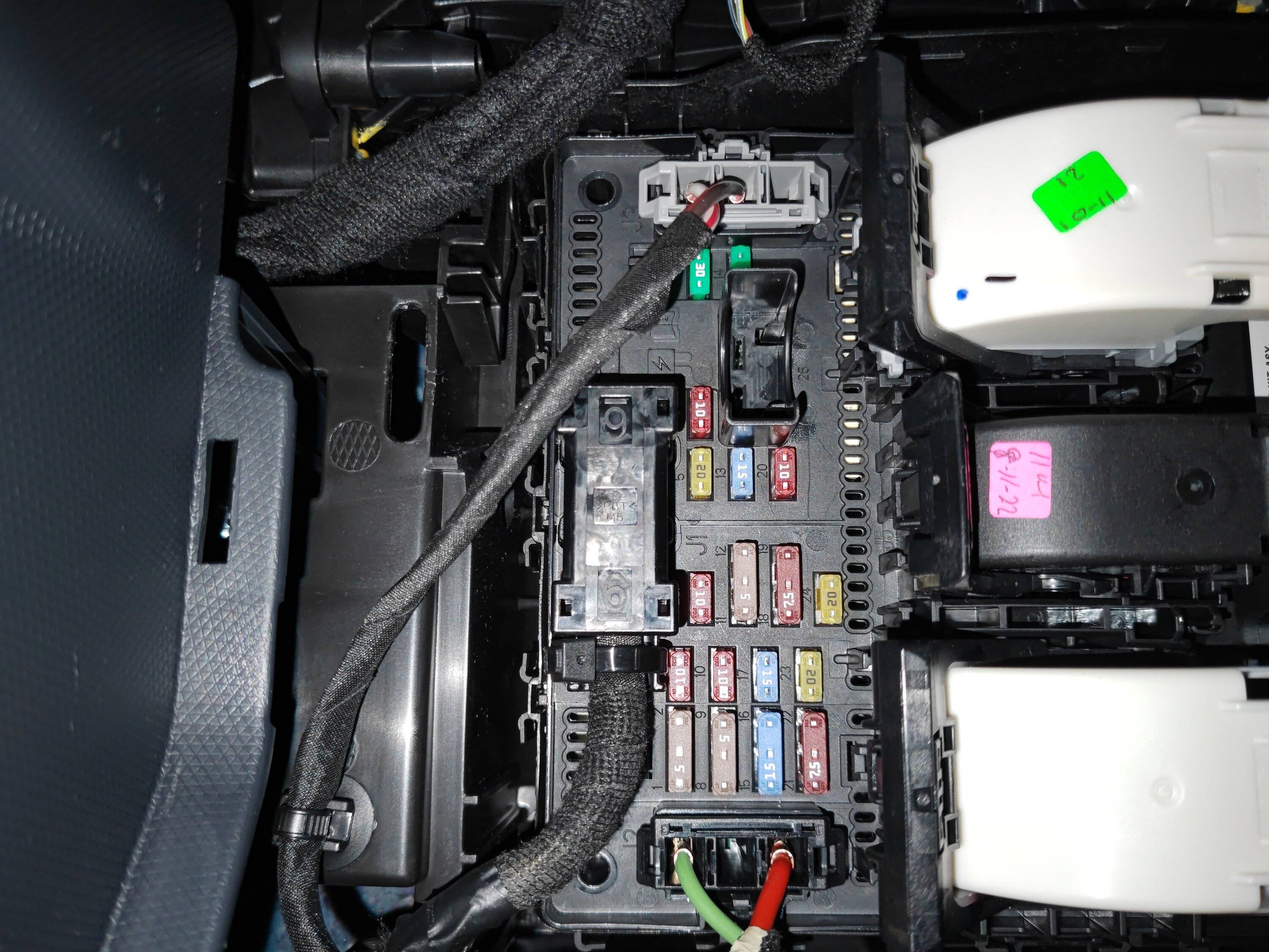

Yeah it’s a known bug, you can also pull the 11 fuse under the passenger footwell if you have zero connectivity.

Since 4.2.2, yes it's present. It used to not show up but I still had connectivity. There was an issue with TCU would get stuck and need to be restarted that's why I pulled the fuse. I figured this was fixed in latest updates, but YMMV. So unpredictable :(

Decided to search the forum before posting and sure enough found this thread. My vehicle got 4.2.4 last week, and ever since I noticed my connectivity symbol is gone. I pulled the fuses and didn't help, then I noticed on two occasions I went out after dark and in both cases the symbol (and subsequent menu items) came back, the next day, gone again. But then I also noticed despite the symbol not being there, my vehicle still seemed to have connectivity (software update check, traffic, weather, navigation) so I stopped worrying about it.
