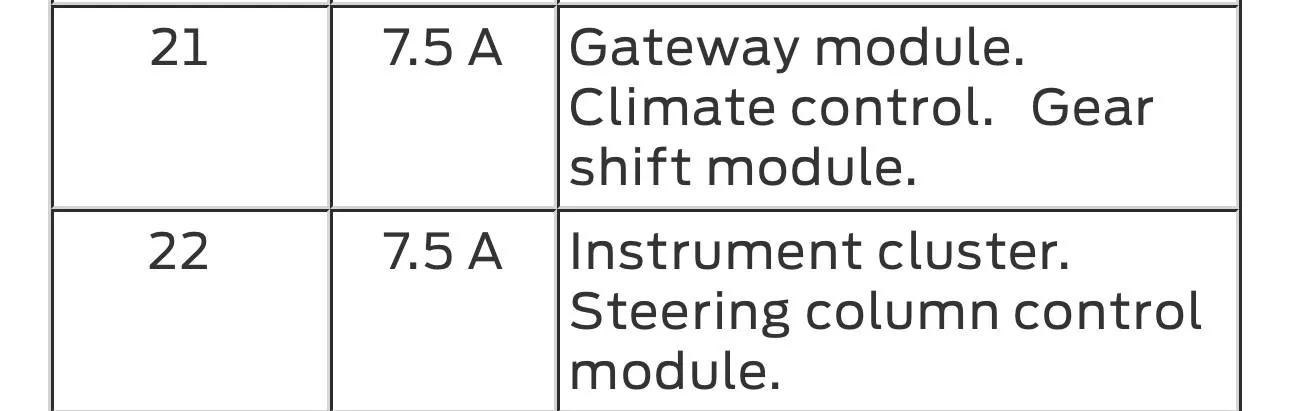

Chiming in to add my experience.
One day my car just did this. No chargers on map, no bluecruise handsfree, no updates in fordpass and no remote lock/start from fordpass. The Connected Vehicle Features submenu was grayed out, the blue cruise until was blank. The bezel diagnostics showed "waiting for diagnostic data" for TCU and ECG screens for everything. I tried sync reset, key cycles, and pulling fuse 11.
Called Ford, they suggested everything I already did from forum, but did it again. One rep strangely told me to call AT&T about it, before I got forwarded to someone else after stating that I shouldn't possibly be talking to AT&T about Ford's connection. I got escalated and will be contacted about it at some point. In the mean time, since both TCU and 'ECG' (evidently referred to everywhere else as GWM/Gateway Module) seemed logically related to this whole thing, I pulled the 21/22 fuse) For my problem, that did it, pulling/replugging the GWM fuse brought everything back to life.
cyberkiko
Alberto
Aug 15, 2023
Miami
Mach-E Select
thanks for the tip jj4242 I did all the mentioned but only fuse 21/22 resolved the issue.
Pulled fuse 21/22 and voila, all is back.
Just need to receive recent software update to 6.13.0. Update Now button is grayed out.
Thank you JJ4242!
