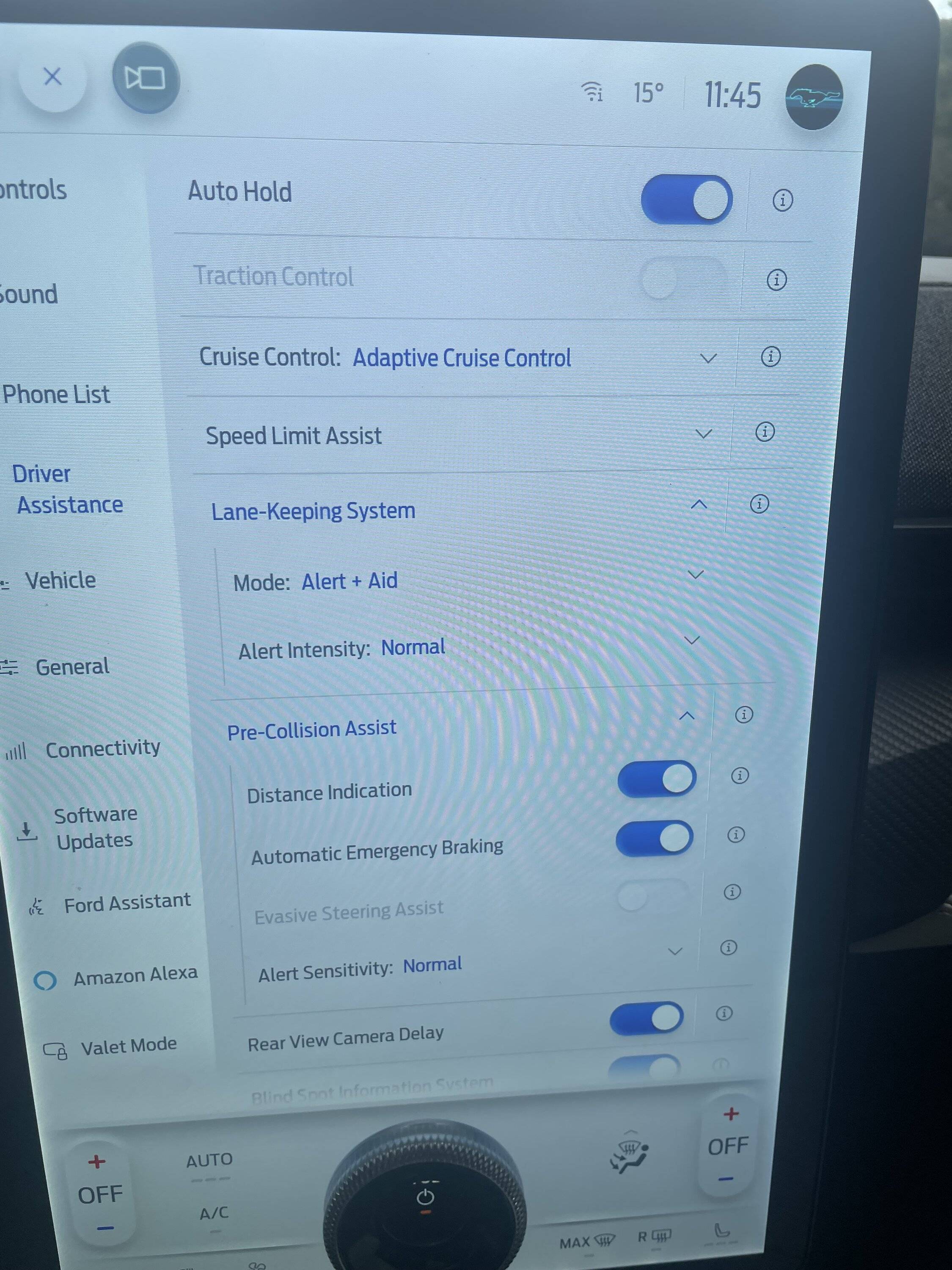

Ford Mustang Mach-E Can't turn on "Traction Control" or "Evasive Steering Assist" IMG_4810
Now it’s greying out the options. Anyone had this issue?

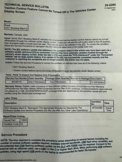

I´ve found this technical service bulletin on facebook but it seems only applies for Canada and USA markets and not for European cars.
Has anyone more ideas?
Thanks.
