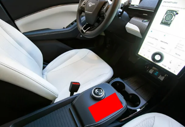

But the problem goes away if you place the phone on the dash behind the screen, I've tested this multiple times. So it's clearly some sort of GPS interference, which I'm not sure how it would be fixed on Apple's side.
I’ve also put it in the sunglasses holder and it hasnt screwed up there either.

I've had this issue ever since I got my Mach-E. Both with an iPhone 13 Pro and still (but less often) with an iPhone 15 Pro. Putting it in the cupholder and giving the phone a clear view of the sky seems to fix it.
Never had any CarPlay issues in my old Genesis but that was wired. I feel inclined to blame the car since its obnoxious faraday cage attributes make it almost impossible to activate my garage's RFID pass. I imagine GPS signals are having the same issue.
