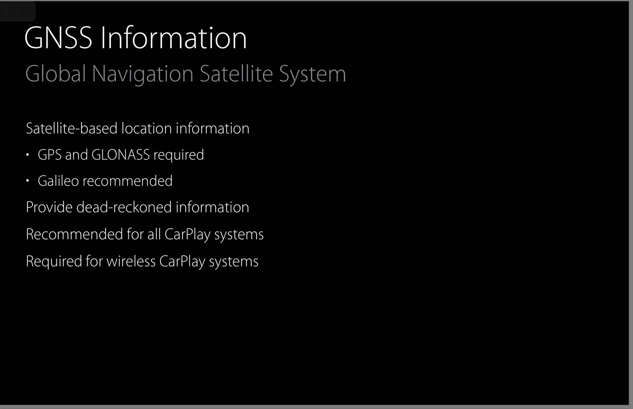

This would be a Ford software stack issue, technically. Wired CarPlay has the option from the automaker to use either the car’s GPS information from its antenna or the iPhone’s. Wireless CarPlay is required to use the car’s GPS information because it’s assumed the phone will be in a pocket or a bag and might not have clear view of the sky. I think there’s something broken in Ford’s technology stack, because I too have found poor Apple Maps performance when my phone is in my pocket or otherwise obstructed, and it works fine when on the dash or in a cup holder. It’s clearly not using the car’s GPS antenna/information for positioning.
Ford Mustang Mach-E CarPlay GPS Issues IMG_0411
(I lifted this image from another website’s thread on the same issue; it comes from one of the Apple Developer educational sessions about programming to CarPlay.)
I disagree that it's just a Ford software problem. I've seen this on dozens of vehicles from various makes
