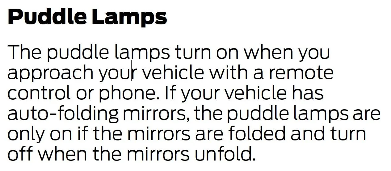

This brings up an ancillary issue of knowing when something is a bug or a feature. I still haven’t figured out when the puddle lights are supposed to come on. I’ve seen them a couple times but have no idea what I did to make them appear.
Ford Mustang Mach-E Carplay vs A/C Screen Shot 2022-07-24 at 4.17.34 PM
(The Owner's Manual has all kinds of interesting information ? )
