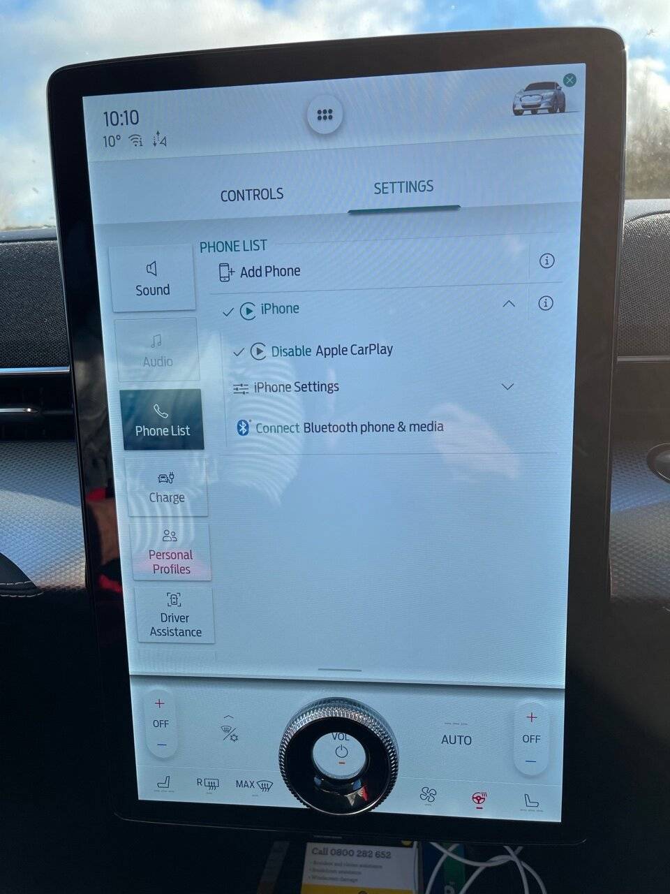

I have a reoccurring intermittent problem with CarPlay.
I get into the car and the music starts to play from my phone through CarPlay.

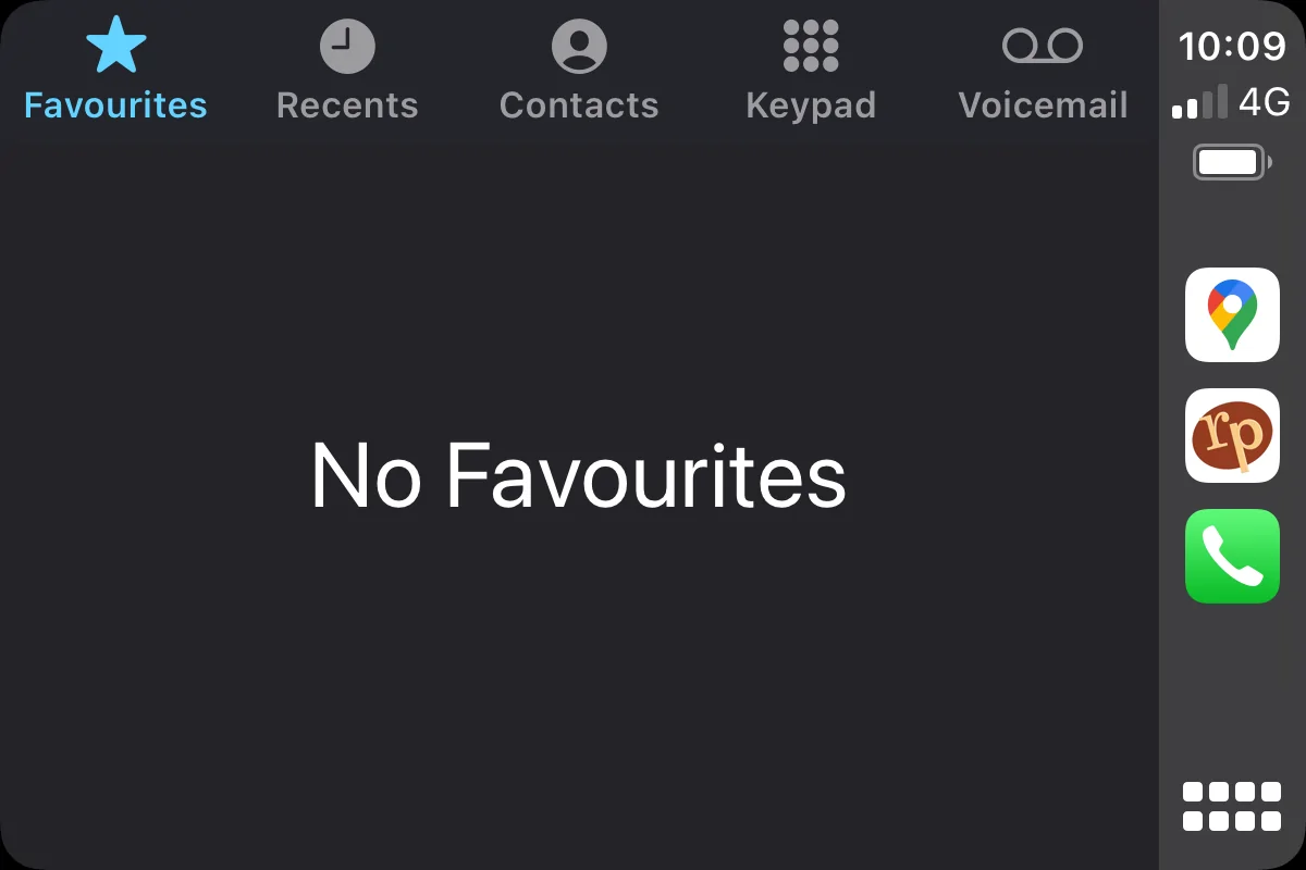

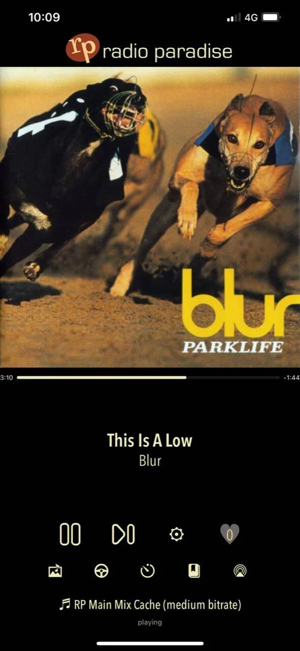

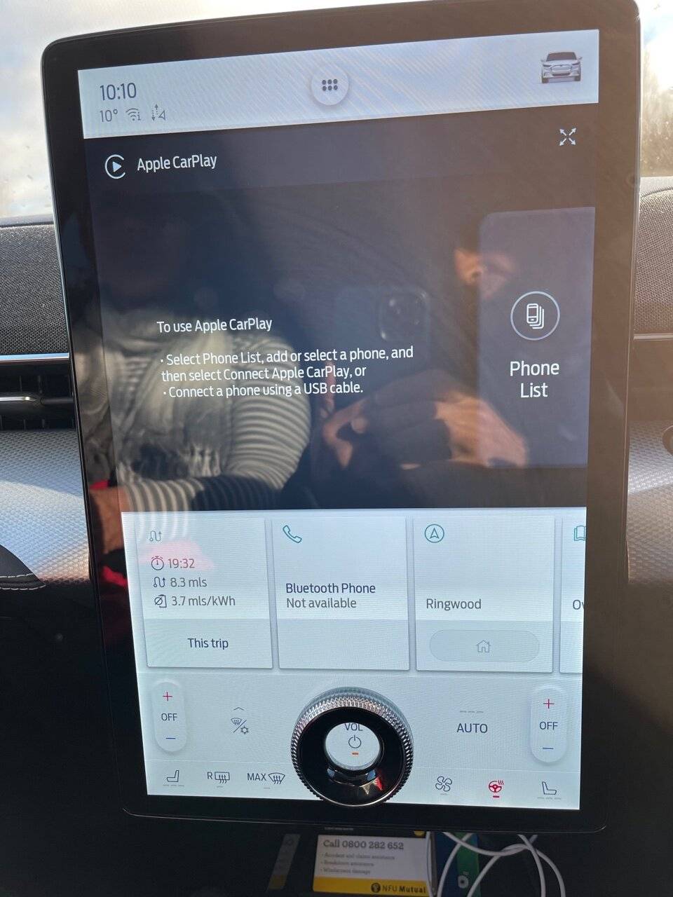

However I get a screen indicating CarPlay is not functioning and there is no ability to select any other app. Going to start CarPlay shows a screen that says CarPlay is working (and music is playing) but it is not working properly. An iPhone screen capture shows the two screens of CarPlay working correctly.
Ford tell me to take it to my dealer. I know they cannot fix it as it is a bug.

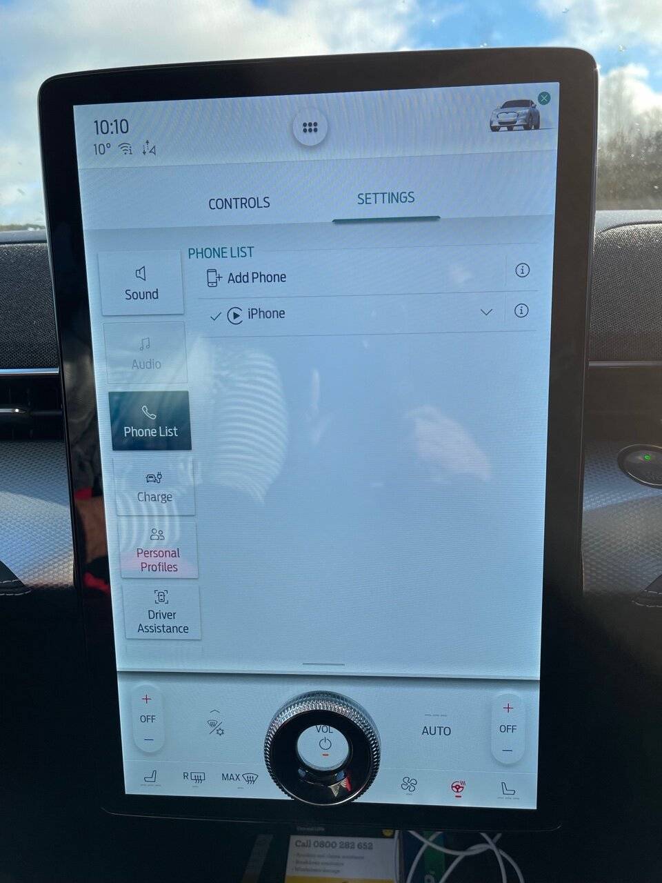

I now know how to get it working, I tell CarPlay to disconnect and then tell it to connect and normal function returns. However this is a PIA.
Has anyone else had this problem?
