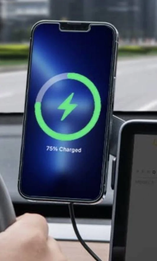

I have this problem frequently, though usually it resolves itself within a few minutes. However I find that if I put my phone on my phone holder next to the center screen, it clears right up. (This is not my photo)
