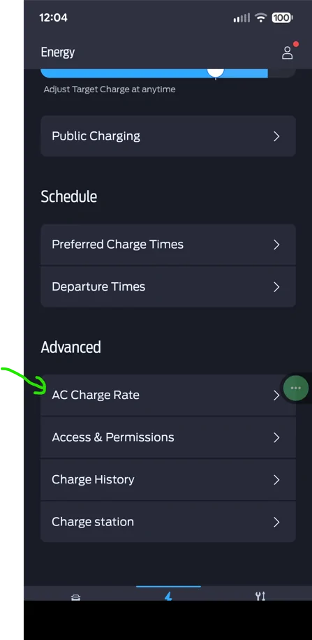

We have a Ford Pro Charger, and we adjust max charge and charging rate through the Ford Pass app. In addition, we've limited the max charge rate to 32 amps on the dial inside the physical charger.
Is there another way to be able to easily vary the charge rate from the Ford App that I'm missing?
ChrisO
Jan 11, 2025
998
992
US
There is for the 2025 Mach-Es, but there wasn't in the 2024 Mach-Es.
