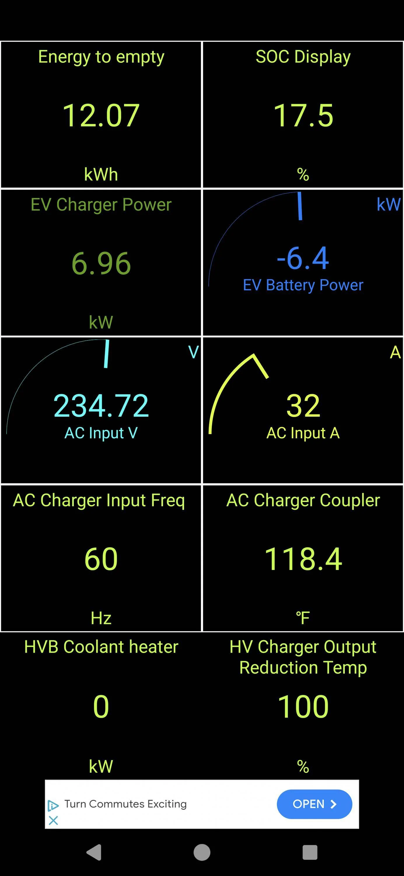

FordPass reported "6 kW" for this charge but my OBD2 was reporting 6.96, so it's far from exact.
Ford Mustang Mach-E Charger Overhead? Screenshot_20240103-121556
