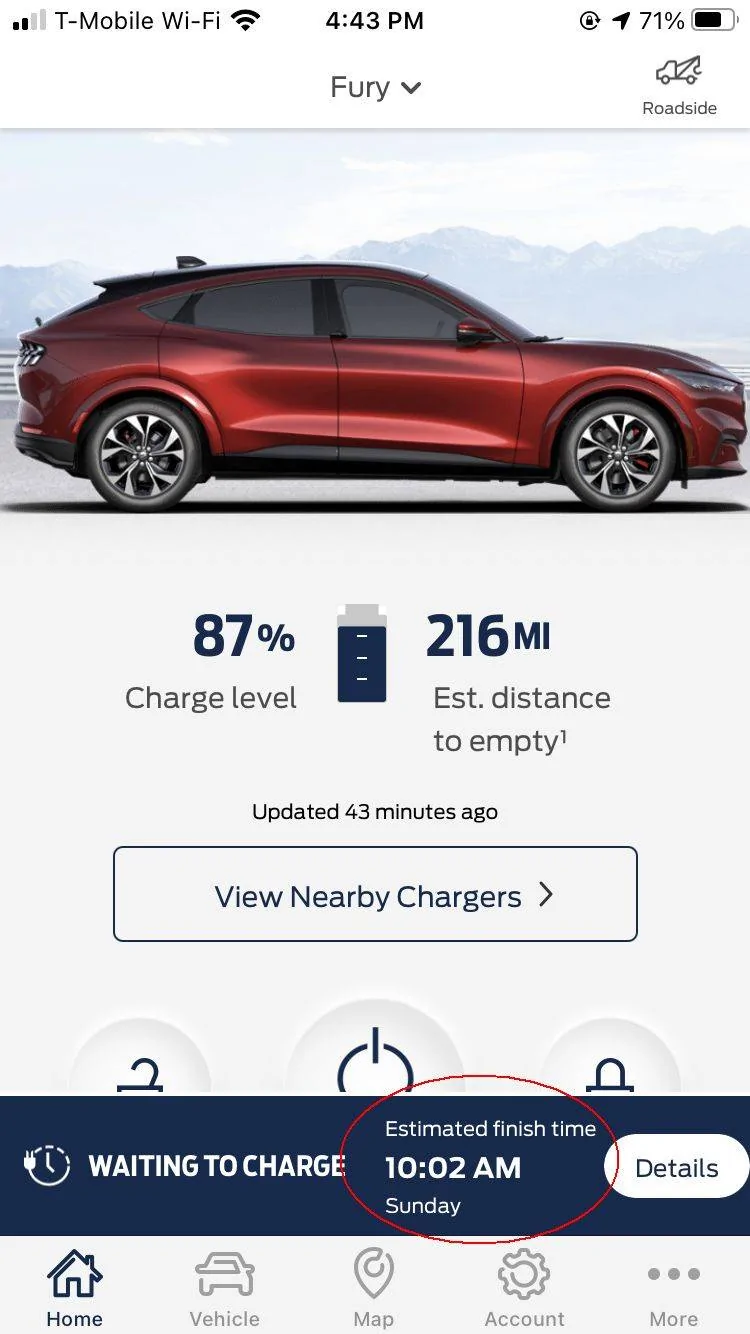

So I drive a bit today , come home plug in around 3 PM ish.
I see this following message on Ford pass - note it says charging to be completed Sunday - and I am like whats up - should be charging tonight not sunday -

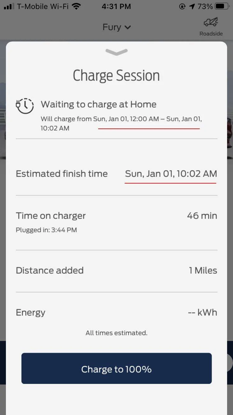

So I click on details and see this - note that it says it will charge on Sunday JAN 01...Zees this is April.
Ford Mustang Mach-E Charging issues with Mach E at home IMG_1205
So I will see what happens tonight and I sent these images to teh service manager at the dealer - did not hear back.
But these images make me think that the reason teh car has not initiated charging Sun through wednesday is perhaps its looking at some random day in the past and is messed up and not initiating charge...
How does Ford Pass display these incorrect dates? It connects to the car and gets messages from the car and the car is looking what to get these dates? Is it possible that the car pings some server at the mother ship and is getting this erroneous info and then does not initiate charging as its looking for Jan 1 which is in the past? Cant explain - and not sure why it charged thursday....

I would recommend that you skip the fordpass app For the following. Go out to your car. Unplug it. Turn it on. Delete your home location. Plug it back in. Re-save your home location and redo your charge preferences from the screen in the car. Give it a few hours to resync with fordpass and THEN see how it goes.

Update:
I deleted location and charged and added presets in the car and not the app. Charging at preset times seems to work but precondition does not seem to work. No precon this morning.
have not heard from dealer yet and taking it to dealer on Monday ...
