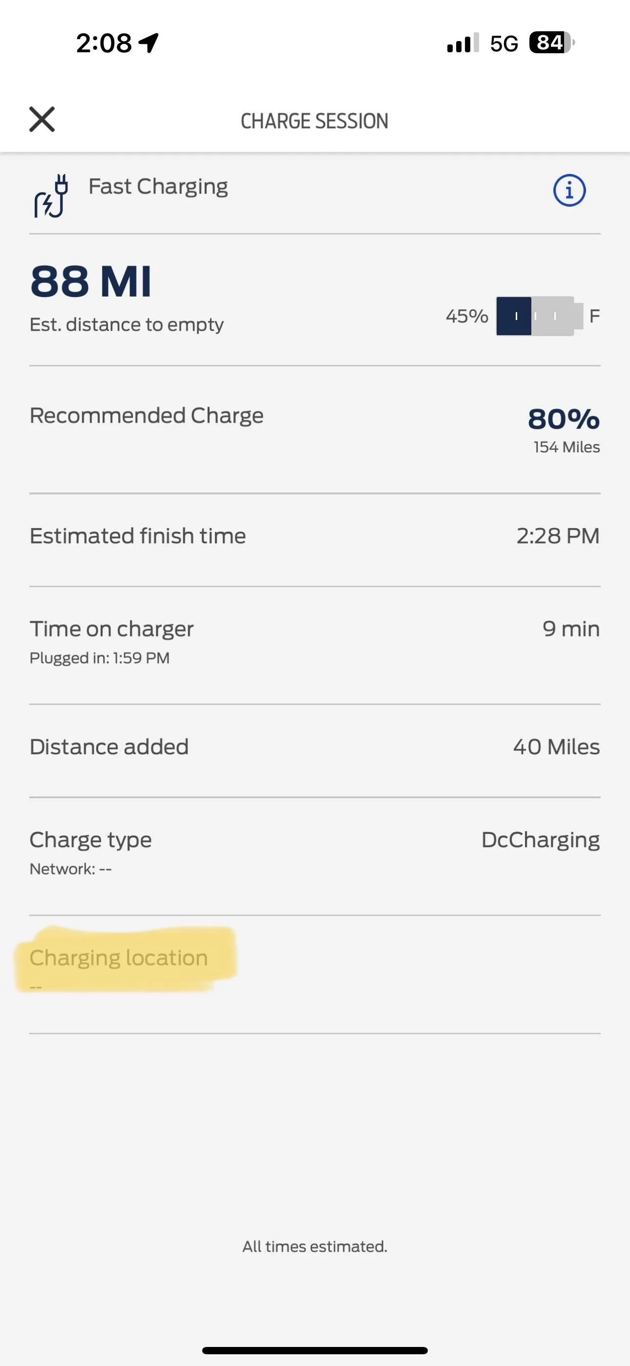

What does the app say in charging details when its plugged in an stops charging? I am wondering if you have a previous location setup. Also, once the battery is topped off for example our car, I have it set to stop charging once it hits 90%. The car wont' charge anymore once its done charging, this is normal but to figure outs going on with yours need more info.
1. At what % is the car saying its "done charging?"
2. Post a screen shot of the details in the Ford App when it’s done charging.
Info is key here, without it can't help you.
I attached an example of what page I am talking about. Yellow will populate if you have a saved charging location, not needed.
