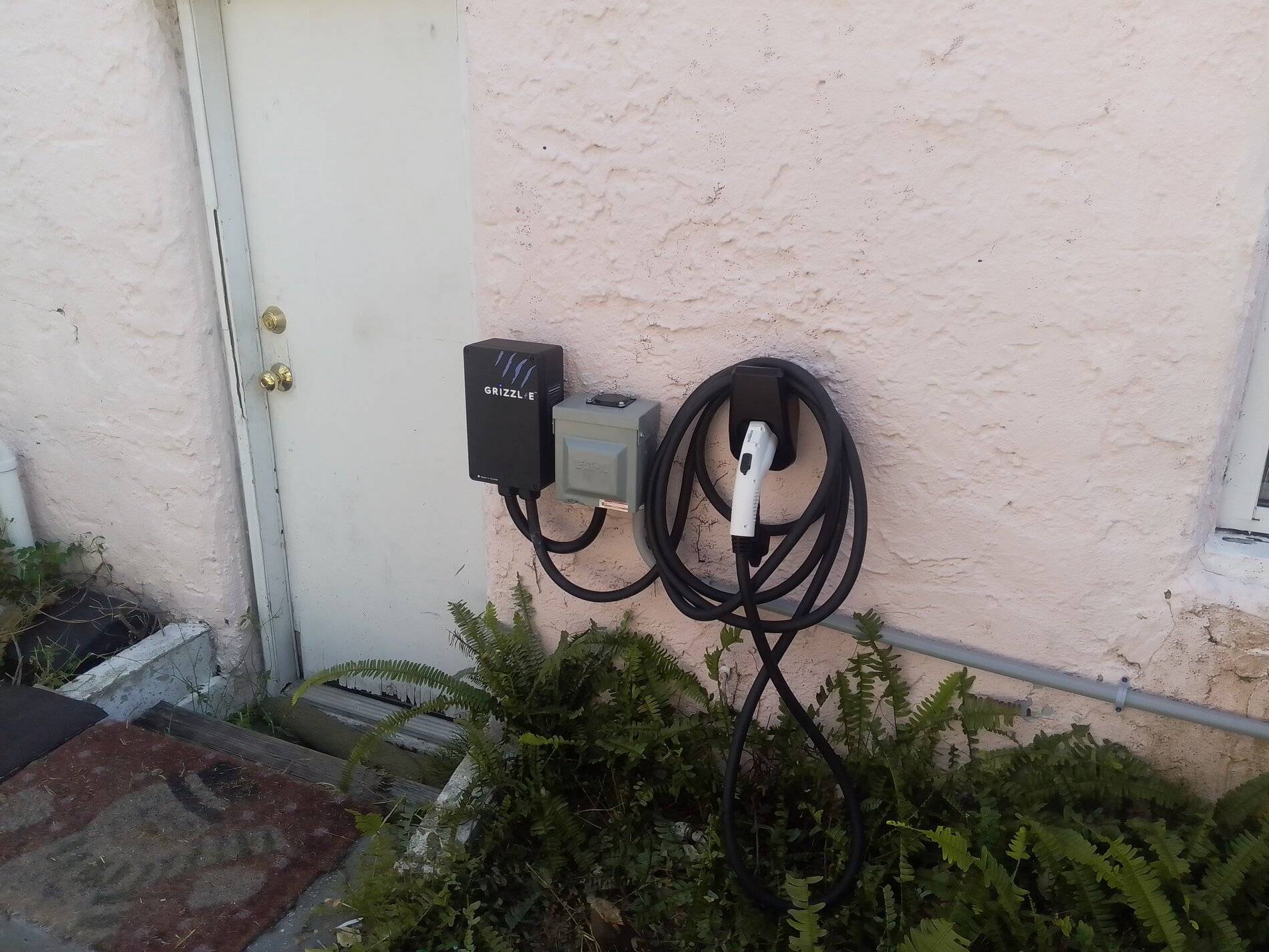

Considering you will never have to visit the local fuel station ever again it is not too bad.
My garage is also detached so I just stuck my charger on the side of the house. With a 24 ft cord have no troubles and it kept install costs on the outlet and charger down. Being the house and garage were built in 28' all is good. Mustang lives outside.
Ford Mustang Mach-E Charging Mach-e at home IMG_20210227_102934
