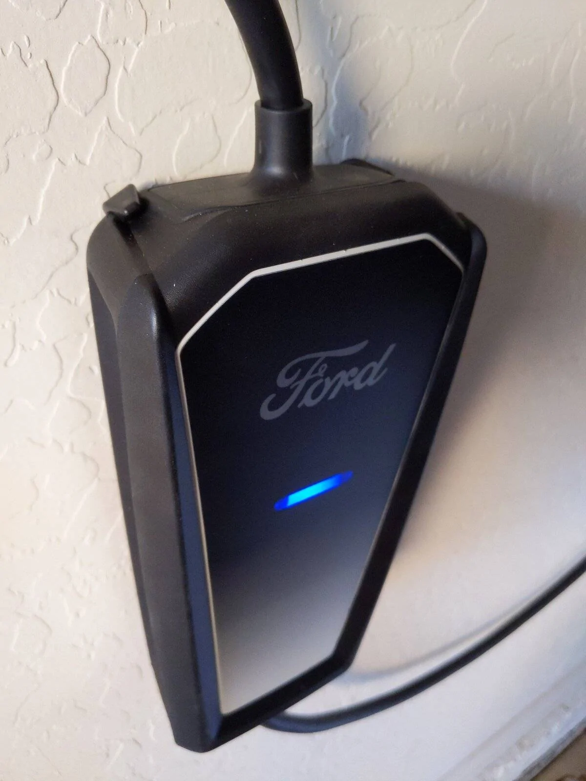

Its colors are amber, blue, and red. So I think you are seeing the solid red?
Scroll down this page for troubleshooting the color/flashing indicators:
https://www.fordservicecontent.com/...&userMarket=USA&div=f&vFilteringEnabled=False
There may be something wrong with your outlet wiring or the mobile charger itself.
The connector requires very firm insertion in order to be fully seated. Double check that it is flush with the body of the mobile charger, like this one. If it is fully flush, then you may need to head back to a dealer for replacement or further troubleshooting.
Push it in very hard until you hear a click

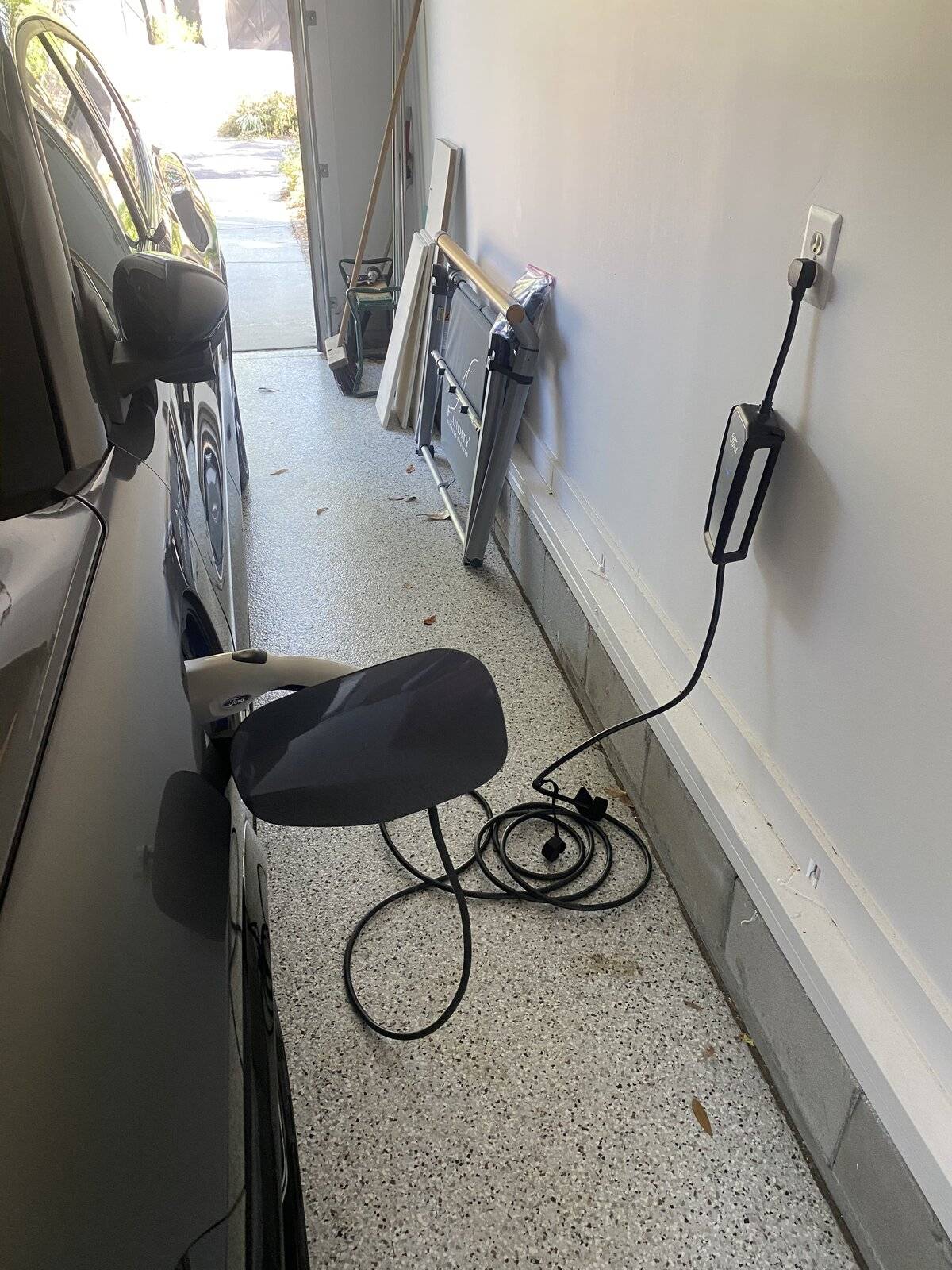

I want to thank everyone for their input. The problem was that I was not engaging the plug in to the charger hard enough. Once I did that and followed the process, it worked.....

Awesome! And hey, that's a nice looking car.
The charger includes a bracket and some screws so that you can attach the bracket to your wall and relieve the weight stress off your outlet.
Highly recommended that the cord not dangle from the cheap plastic 120V socket.
