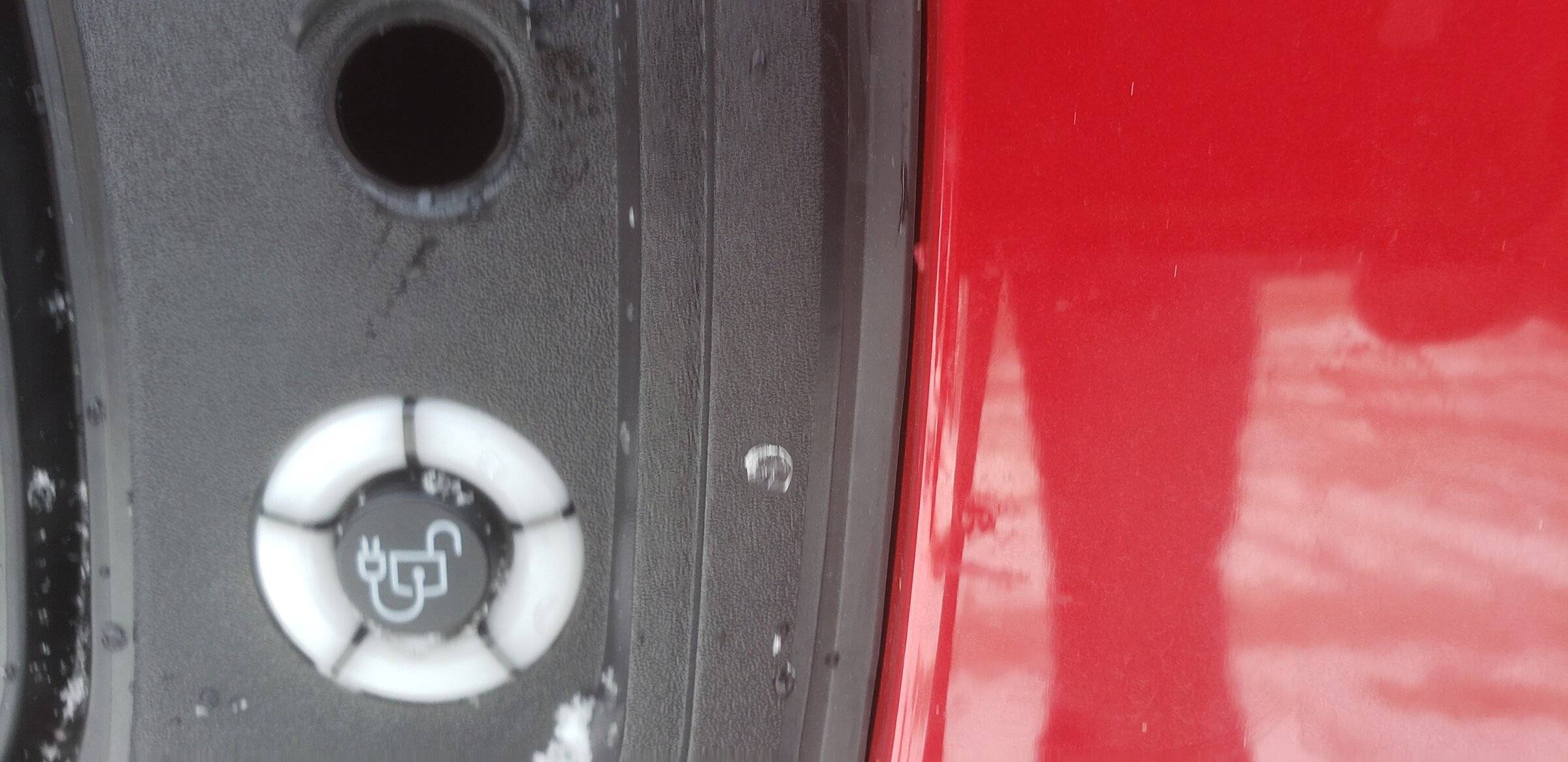

Happend to me the first winter, and seems it happening again this winter :/ Whole thing had to be replaced the first time too as it got pushed into the car like yours.

This happened to me on Wednesday made an appointment at my dealer for Thursday and had the car back by the end of the day with a new charge door all covered by warranty.

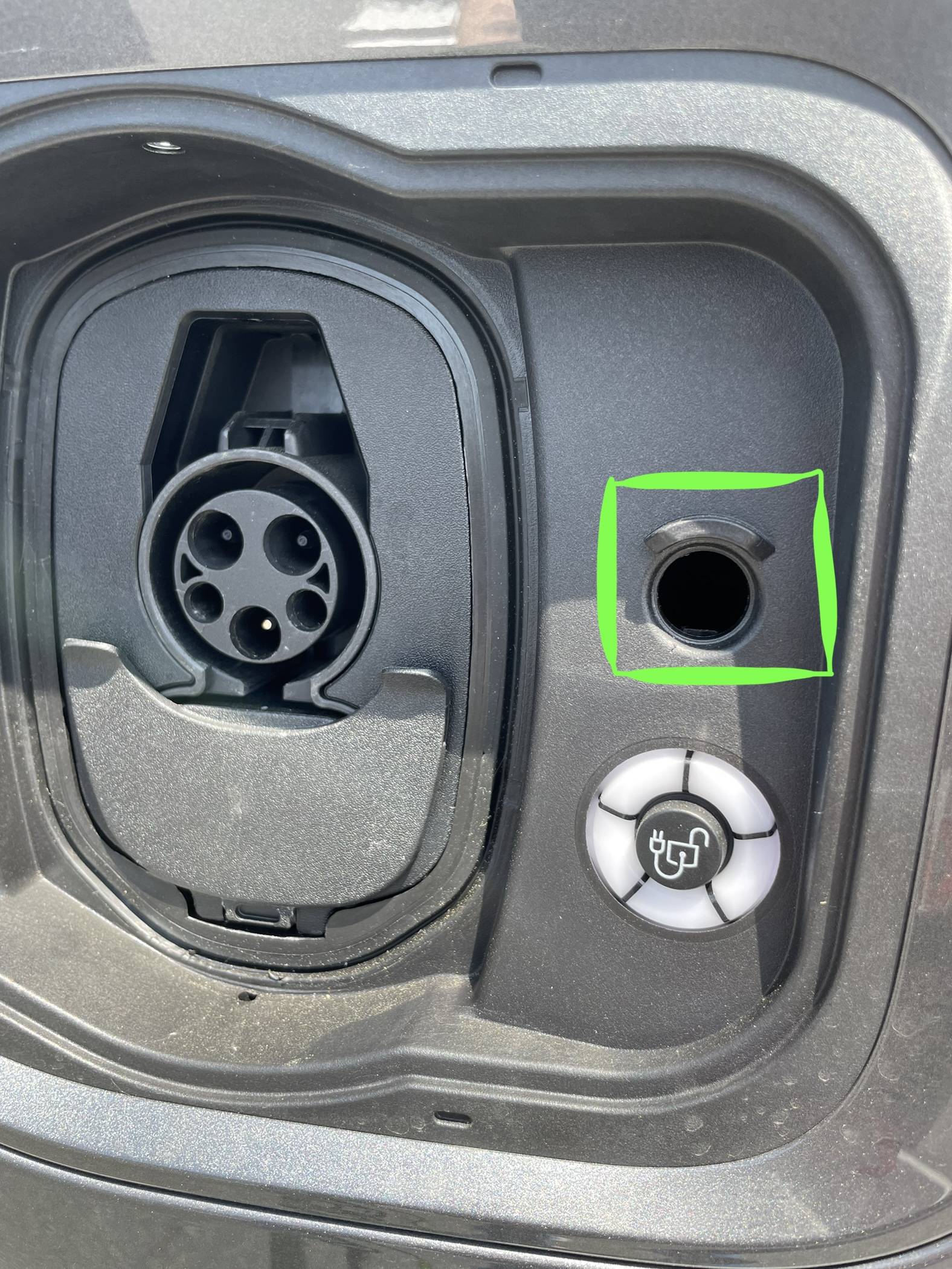

that part didn't solve my problem, unfortunately. On my end, as like the pictures above, it appears that there is a 'receiving' piece that fell into the car. The piece that I ordered from the link above seems to be the 'male' end of the thing, but what's missing is a female part - something that will accept the male piece and lock it in. This is beginning to sound like a single's ad ;)

interesting! I don't even know what I am looking at! Is the part you listed the female port? looks kinda big - when mine fell out into the car, it didn't sound like a big clunk, more like a dime falling inside. If i knew how to get in there, I bet i'd find it in there!
What was the resolution for your charge port door latch? Mine just fell into the fender yesterday, but I was able to retrieve it from the felt liner at the bottom of the fender.
