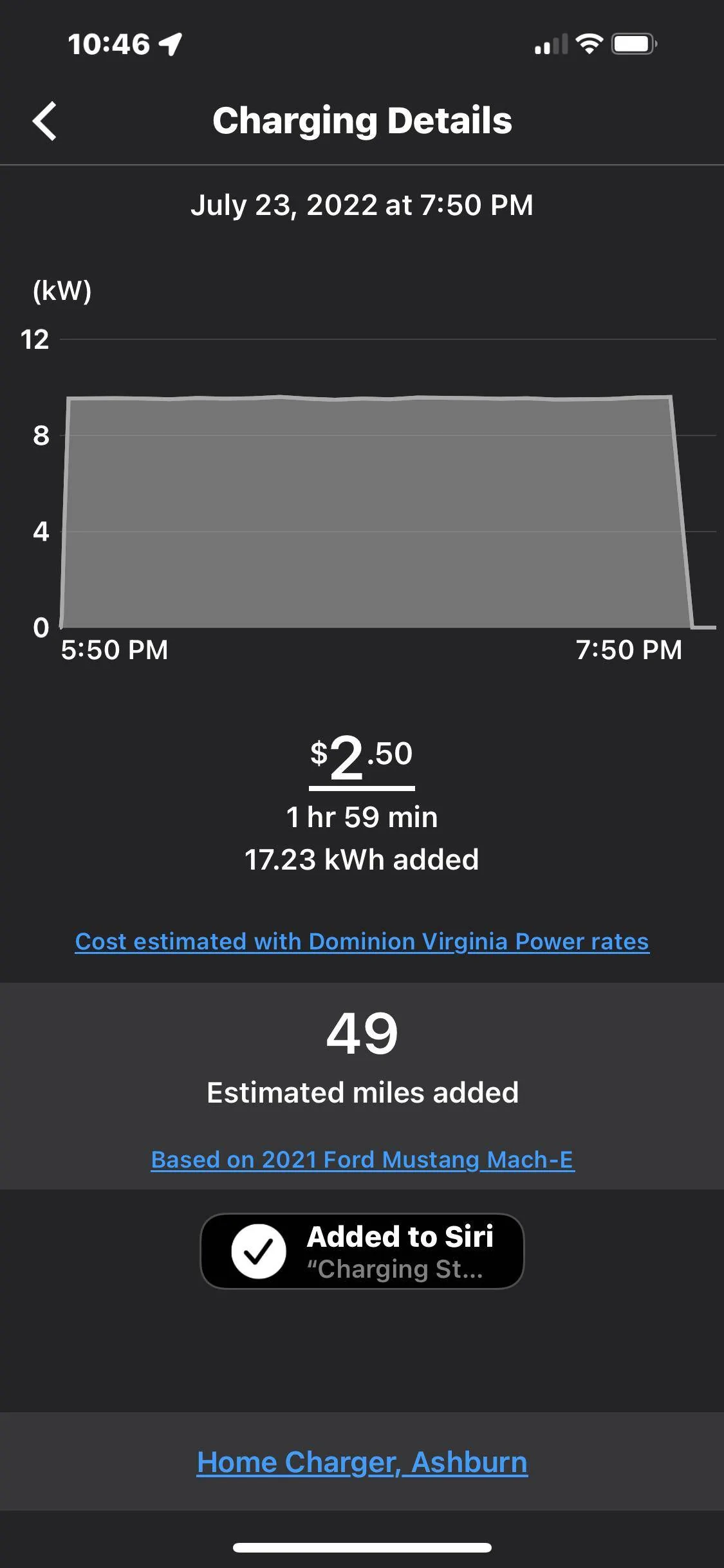

If you have a dedicated garage - is there a fuse panel nearby? Perhaps the landlord would be willing to allow a 240V NEMA 14-50 to be wired into the garage? However, this would requre 6 gauge wiring. Tell the landlord he is "making an investment in the future value of his building". If you were able to get the NEMA 14-50 240V on a 50 Amp breaker using 6 gauge wire, you could plug the Ford charger in using the 240 adapter which would get you about 20 mph into the vehicle. I have a Chargepoint flex plugged into a NEMA 14-50 240V on a 50 Amp breaker using 6 gauge wire in my garage, and it puts roughly 25 mph into the vehicle. It does slow down a little when battery reaches 80%, and I have the Ford app set to stop charging at 90% by default. So the ChargePoint Flex is definitely a little fster than the Ford charger using the same plug. I have attached a screenshot from the ChargePoint app that shows the charge progress on a recent 2 hour charge.

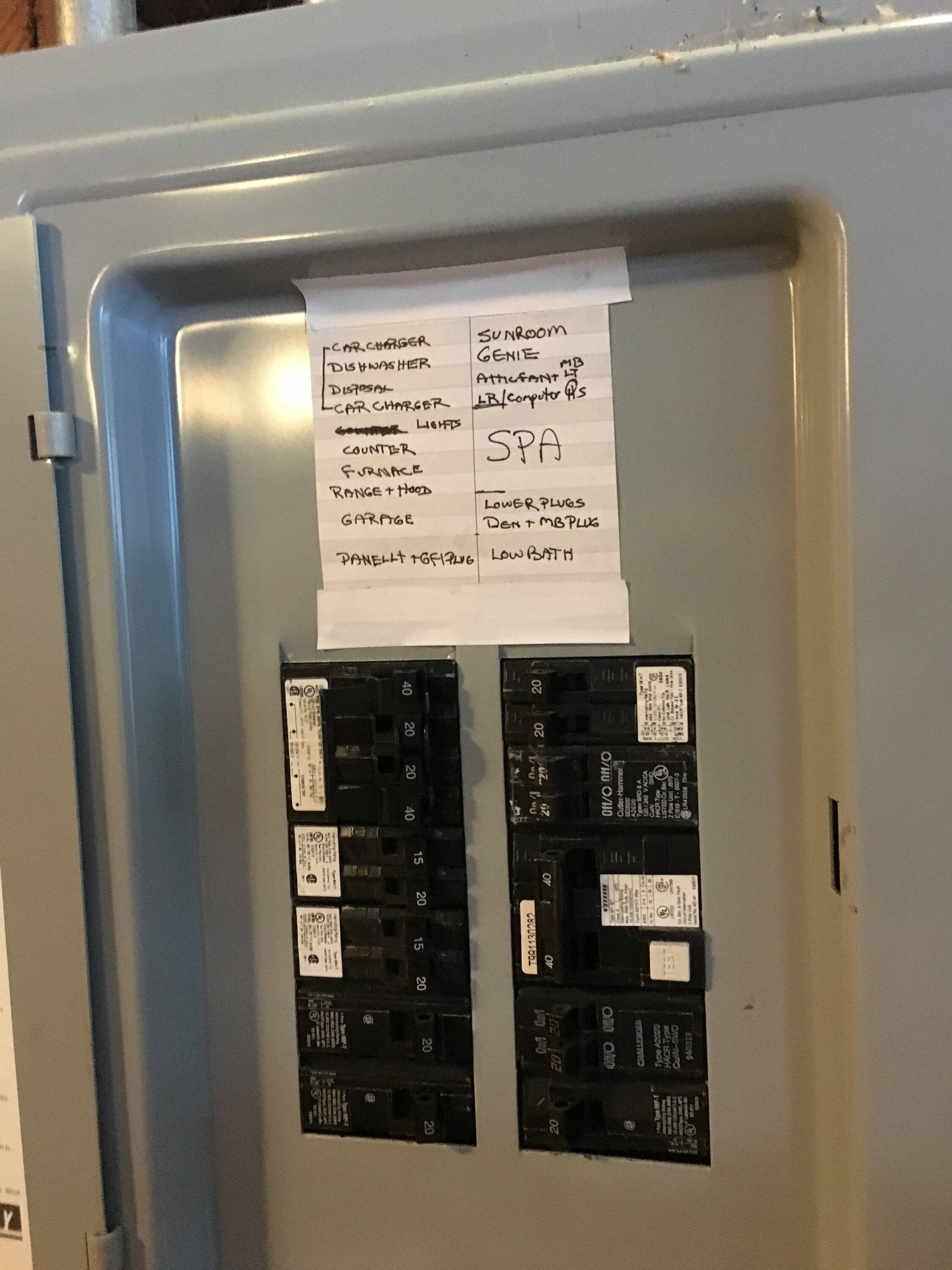

Interesting device. If you are thinking about purchasing it, pay attention to " two different 110-120 volt circuits that are out of phase". In a standard fuse panel there will be two columns of breakers. The two 120V outlets that are going to be combined must be one from the left column and one from the right column - in all likelihood that will provide two outlets on different phases. You can test this before you buy it by identifying where the breakers are in the fuse panel that you will be using.
That’s not remotely true these days. In my panel, every other breaker slot going down the column is on a different phase. The top slots, left and right, are on the same phase. The next set of slots are on the other phase. And then back to,the first phase. The wiring diagram for the panel shows this. I’m using tandem breakers here, so the first two breakers are on one phase, then the next two breakers are on the other slot. Notice that the 40A double pole breaker for the EVSE has two 20A breakers in between.
