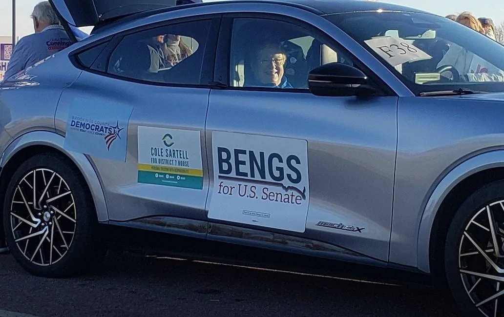

I was under the impression that the doors are steel? They appear to have got that wrong for a start. I have no magnet to test unfortunately.
I have tried to use magnets to hold vinyl sheets while applying vinyl. Does not stick to the door skins.

Doors are steel, these are magnetic signs.
