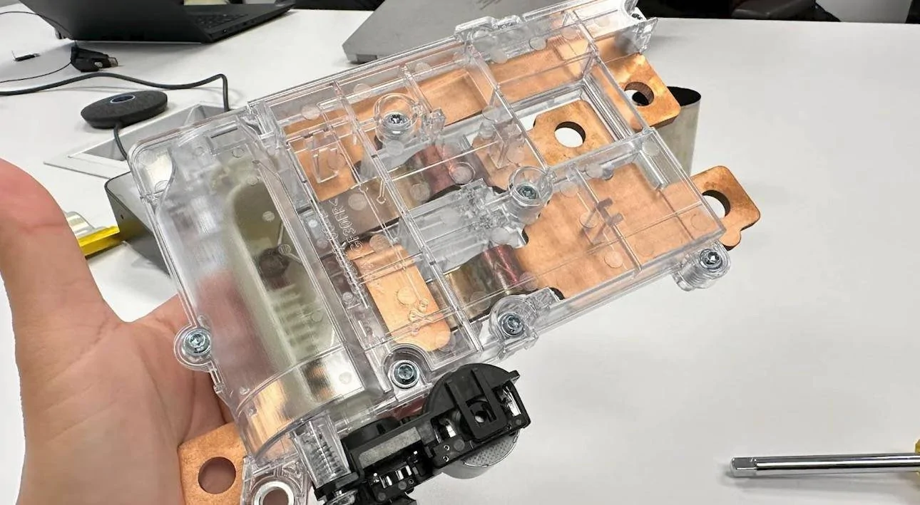

Someone asked me about how the series/parallel 800V/400V switch worked, so I figured it out and drew a representative schematic. It's just a fancy DPDT switch that splits the pack in half. I labeled the switch terminals with numbers.
Ford Mustang Mach-E Cybertruck Engineering Innovations IMG_2456
Ford Mustang Mach-E Cybertruck Engineering Innovations IMG_2455
The black thing is a motor that turns a set of switches. Bus #2 and #3 have contacts on the end and are pushed up and down by the gray bar mechanism to change the connection. In 800V mode #1 and #2 are touching, #3 and #4 are not. In 400V mode bar #3 will be pushed down to touch #1, and #2 will be pushed down to touch #4.
I drew this before I saw the Munro video, but it works exactly like I thought.
