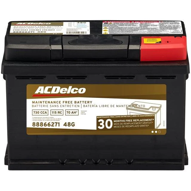

The C8 Corvette uses 48V and they provide a dc-dc converter to 12v, for accessories.
Are you sure about that? Without looking into this too deeply I found the OEM battery for the 2023 C8 Corvette is;
ACDELCO GOLD 30 MONTH WARRANTY BCI GROUP 48 BATTERY
GM Part # 88866271
ACDelco Part # 48G at 12 volt.
Also the alternator and starter both are listed as 12 volts?
