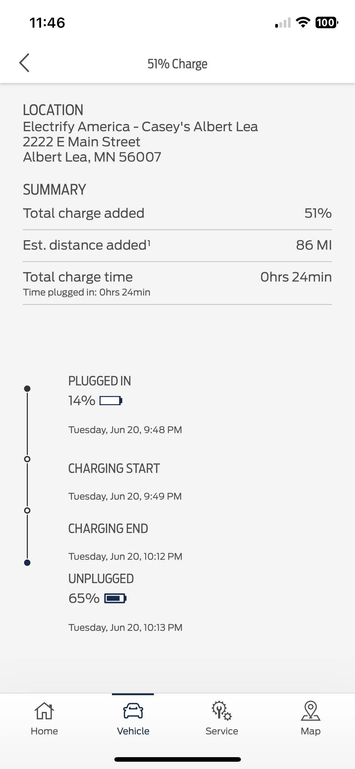

Ok guys, thanks for previously enlightening me about the numbers in the app rolling off while AC charging, that was interesting.
Took the car on a little road trip today, and that required charging at a few fast chargers.
Something isn't adding up though.

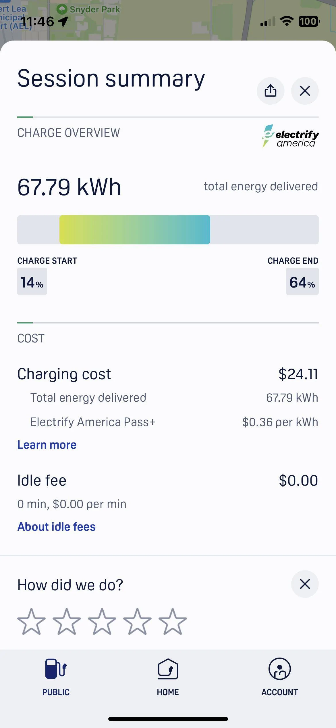

I stopped by an EA station, and according to the charger, they delivered 67.79 kWh of power. I pulled into the station at 14% according to the car and the Ford app, and unplugged at 65% That means I charged 51%
Almost 68 kWh to get half the battery? This has a 70 or 72kWh battery, doesn't it? I know there are inefficiencies in the charge system, and losses due to cell balancing, but lets be honest, if I really only added 50% of the capacity, that would be 36 kWh, where on earth did 32 thousand watt hours of power just go in a half hour of charging? That would be enough to run like 9 hot water heaters, that can't be possible.

The FordPass app is unreliable. What does your EA app say?

Huh. Okay, then. That is weird.
I've never seen that in the ~60 DCFC charges I've done.
I wonder if something weird happened on the EA charger and it didn't clear the previous charging session? Does the car also claim it received 68 kWh?

I have never DCFC’d but did you get billed for 70kWh? Also, and this is where I am ignorant, how much charge did FP indicate for the session? The EA number does seem a bit wacky.

I don't see in the app where it says how much was charged. The page I screenshot doesn't say, is there another place that might say? Thanks for the help.

so the EA numbers must be off, or my math is off because its midnight.
I charged for 24 minutes. thats 0.4 hours.
if I was delivered 67.79 kWh in 0.4 hours, doesn't that mean the average charge rate would have been 169.475 kW? Their email receipt says my max charge rate was 113 kW, and it only seemed to hold at that rate up to about 20%, when it dropped to about 85 kW. There was no way this was averaging 170kw.
My apologies. No, the FP app doesn't include the incoming kWh--I've just become so used to doing the % to kWh calculation in my head that I forgot it's not there.
I think EA had a disconnect bug from the previous charging session and added the previous charge to your bill. I think you have enough evidence in the start and end state of charge % to demonstrate that. Your vehicle doesn't have a 132 kWh battery.
Thank you, that's what I was thinkng.
In addition, the email states max charge rate was 113kW, and it also states I was charging for 24 minutes. If my midnight math is correct again, that means it was only theoretically possible to receive 45.2 kWh of power. We all know that it won't hold 113 for the whole time, as it was hovering around 85 kW most of the charge. 85 * 0.4 is 34 kWh.

With an ER battery (91 kWh) I find that with EA charge events, the % added matches the EA kWh charged +-1. I recently did a 21 kWh charge and FP says I added 21%, for example.
EA is charging for input power, so this means a 9% conversion loss.
Theres definitely something wrong with your numbers for that charge, and it can’t be attributed to higher conversion losses - the charger couldn’t dissipate that much heat.
