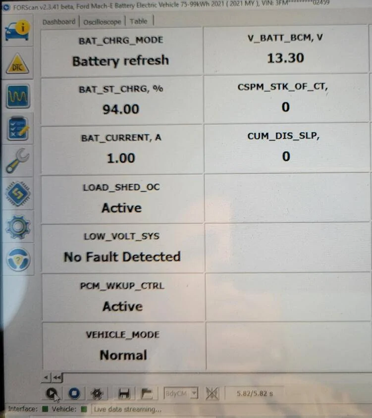

What was your charge mode?
My LVB was 94% this morning with "Battery refresh" as the charge mode.
I don't really know what the various modes mean though.
Here is what I've seen so far
  • Fast Regen Allowed 96% SOC 13.30v
  • Slow Regen Allowed 87.% SOC 14.30v
  • Conventional Charging 86% SOC 14.30v
  • Battery Refresh 89% SOC 14.40v
This morning it said Battery Refresh at 94% with LVB at 13.30v.
Curious what all the various modes are for and when triggered. ?????
Refresh would mean it’s going to charge it up probably all the way to 15V to balance the cells. May be triggered by a low SoC or just on a periodic cycle.
I think the regen modes are holdovers from ICE vehicles where Ford’s smart charge system is used. When you brake it will use the alternator more to charge up the battery sort of like regen. The mode parameters might be reused but mean something different on the Mach-E, FORScan is just interpreting them the same way as an ICE vehicle.
