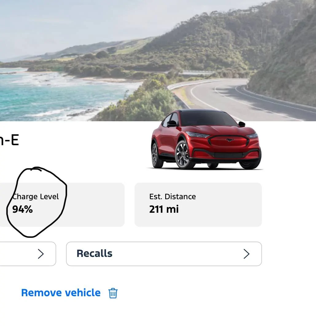

Yes it does, it’s just not labeled clearly.
so what does 12v charge level have to do w/ est. distance? I thought 12v health was measured (as w/ a multimeter) in volts, eg 12.2 or 12.4 as healthy. We used to do this once upon a time.....but must be wrong.
This is charge level. Not health.
