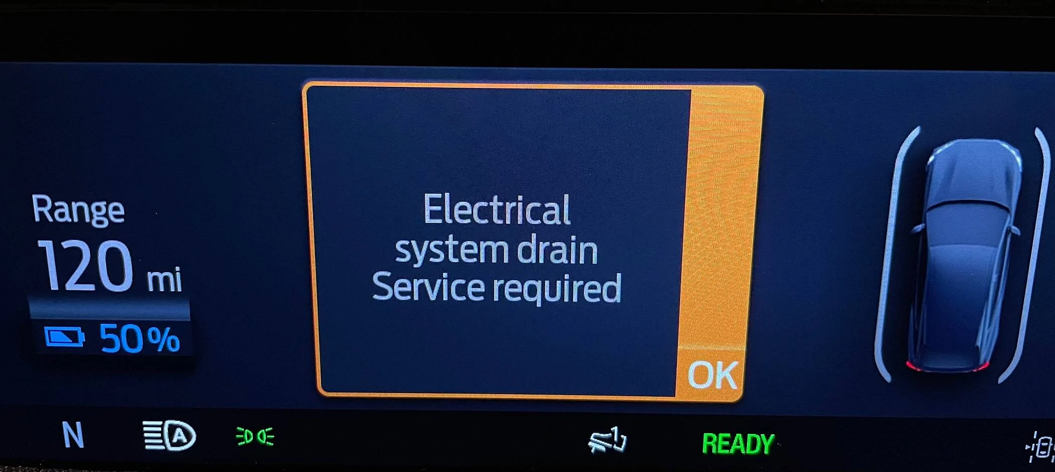

So this has happened to me twice now since getting my 25 Premium EXT about a month ago. Both times it was plugged in and "waiting to charge" but when the charging time arrived the message switched to "Starting Charger" and stayed there, along with the Electrical drain notification.
I just unplugged the charger and plugged it back in and it went back to charging both times without issue. . My bedroom is directly above the garage so I'm thinking it's just the "phone as Key" not letting the car go to sleep.
