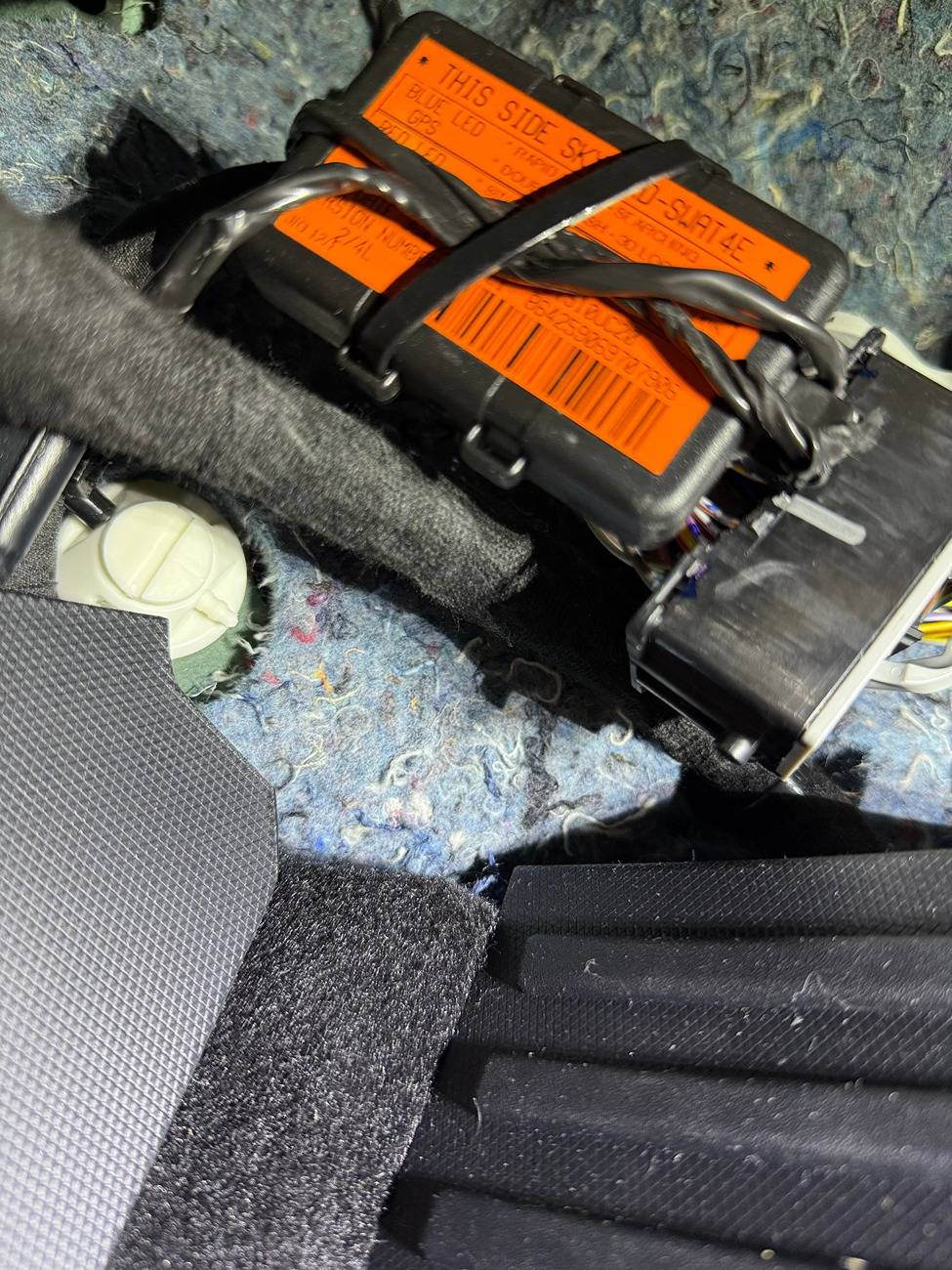

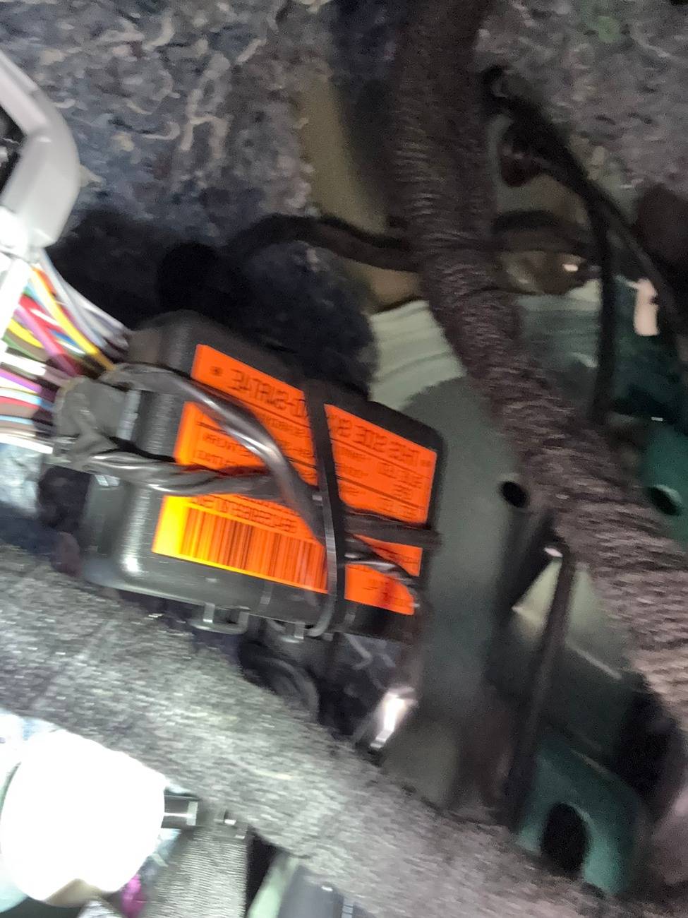

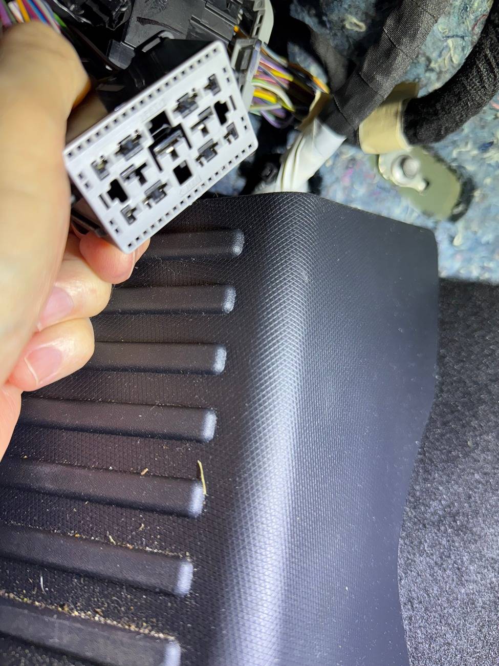

@Mach-Lee Following this post, and after I got the message Electrical System Drain Service Required (I drove it a bit after that), I investigated further and found this device. Attempted to disable it by removing the fuse in it's power line (tapped from their OBD-II replacement connector). Now the car is bricked. I get a sequence of messages, the last asking me if I am connected to a charger and respond on the Info screen (I am not, but I was before this). I click No and the sequence keeps repeating. Car will not shift into gear.
Coincidentally, before I found it and removed the fuse, I charged the night before. I never got a notification about charging complete, FordPass is stuck at 72% (charge did get to 90%), and FP says the vehicle is on. Charge history has not updated in FP or web. Inserting a fuse back into the holder has been troublesome, I think I got it but will triple check today as well as check that the gray connector is secure.
If anyone has ideas, I am open to suggestions. I will disconnect the battery today (Sunday), and will also try to look at diagnostic codes via Forscan (if I can remember how).
2024 GT, 4700 miles.
That connector you're holding (which is a body harness, not an OBD connector) needs to be plugged in, that's factory. It looks like they just zipped tied the box to the harness, cut that zip tie and see if they cut or spliced any wires. If so you'll have to fix that.
That connector has been plugged in all along. I went out to check it and pushed it just in case. It has a latch that is hard to set and I still need to put that back in place. (Working upside down for me is a challenge due to vertigo issues.)
Where I'm at now: car will start.
I still get the Electrical Service message when I start, not the other ones. Also, FP is still not updating and thinks the car is turned on and at 72% charge (it's at 89%) and off.
This morning, I charged to 100% - had to turn off location info in the car to get there. IIRC that also will start charging the LVB after it hits 100%?
That enabled some more functionality, like walkaway lock & notifications from FordPass.
This afternoon: owner.ford.com has a "high alert", contact the dealer. I did that.
Then I hooked up FORscan - it's been a while and never on this vehicle. After checking the DTCs, I mistakenly cleared them all!
And now things look much happier! The information in FordPass immediately updated to match the car data (charge 100% instead of 72%, range 282 instead of 185 - this had stopped to some time on Friday night, Vehicle Parked/was Vehicle On).
Charge History for yesterday and this AM is lost, but I track through Emporia as well.
I have an appointment with the dealer on Wednesday, but not sure if this will be necessary unless the DTCs return. I don't know if they are capable of running diagnostics without that.
