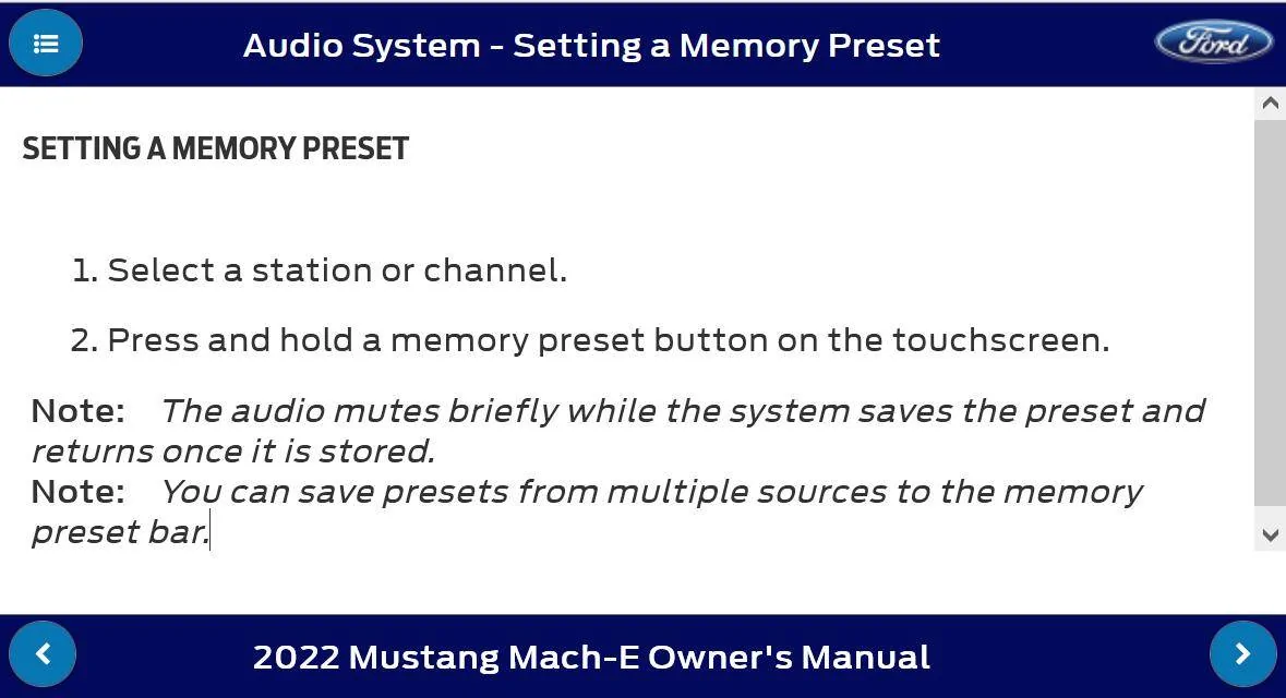

Tune to the station you want and then hold in the preset location you want to save it to.
Thank you!! I was having difficulty figuring this out. Too bad it's not in the manual.
