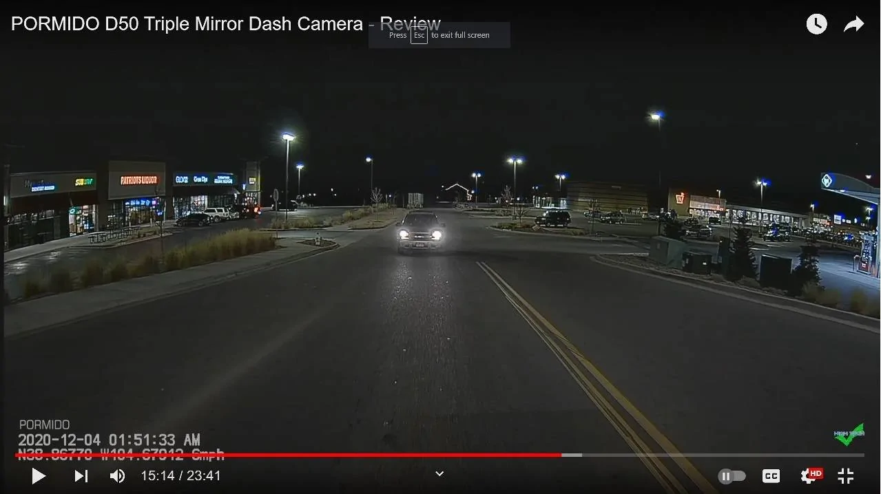

The resolution at night wasn't that great though, headlights were pretty much the only thing you could see. Hopefully your system is better at night.
This is 100% the reason why I will always go with a traditional mirror. It becomes a hazard at night or during severe weather (which is really the time you need to depend on it the most).
satchel prefect
Sep 2, 2022
157
274
South Florida, USA
Crusty old PHEV
This particular model does better at night than my factory mirror. The glare from the headlights is far less intrusive in this image than in the glass mirror, even an auto dimming one.
Ford Mustang Mach-E Digital Rearview Mirror Installed night sampl

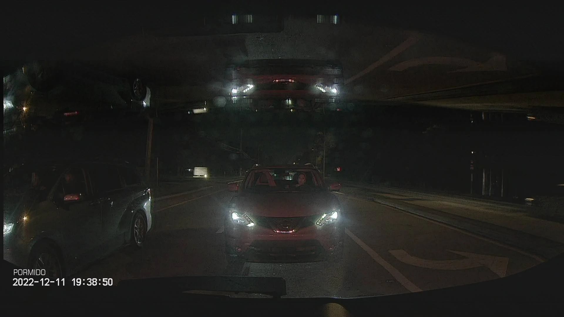

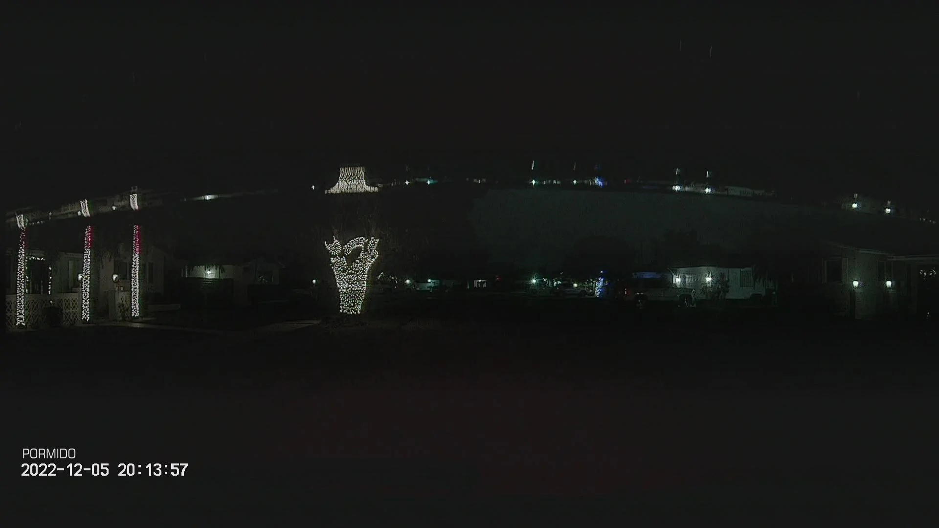

I should clarify first that the still night shot in posts #12 and #18 were from the video I cited in post #12--not from my setup.
Here are some actual night time stills from my internally mounted rear camera:
Ford Mustang Mach-E Digital Rearview Mirror Installed empty street
Ford Mustang Mach-E Digital Rearview Mirror Installed IMG221211-193550R
The first image is an empty street with porch and Christmas lights but no street lights. The second one is a three-lane 40mph surface street. As you can see, there's plenty of info to identify the car behind me, and enough resolution to capture a front license plate.

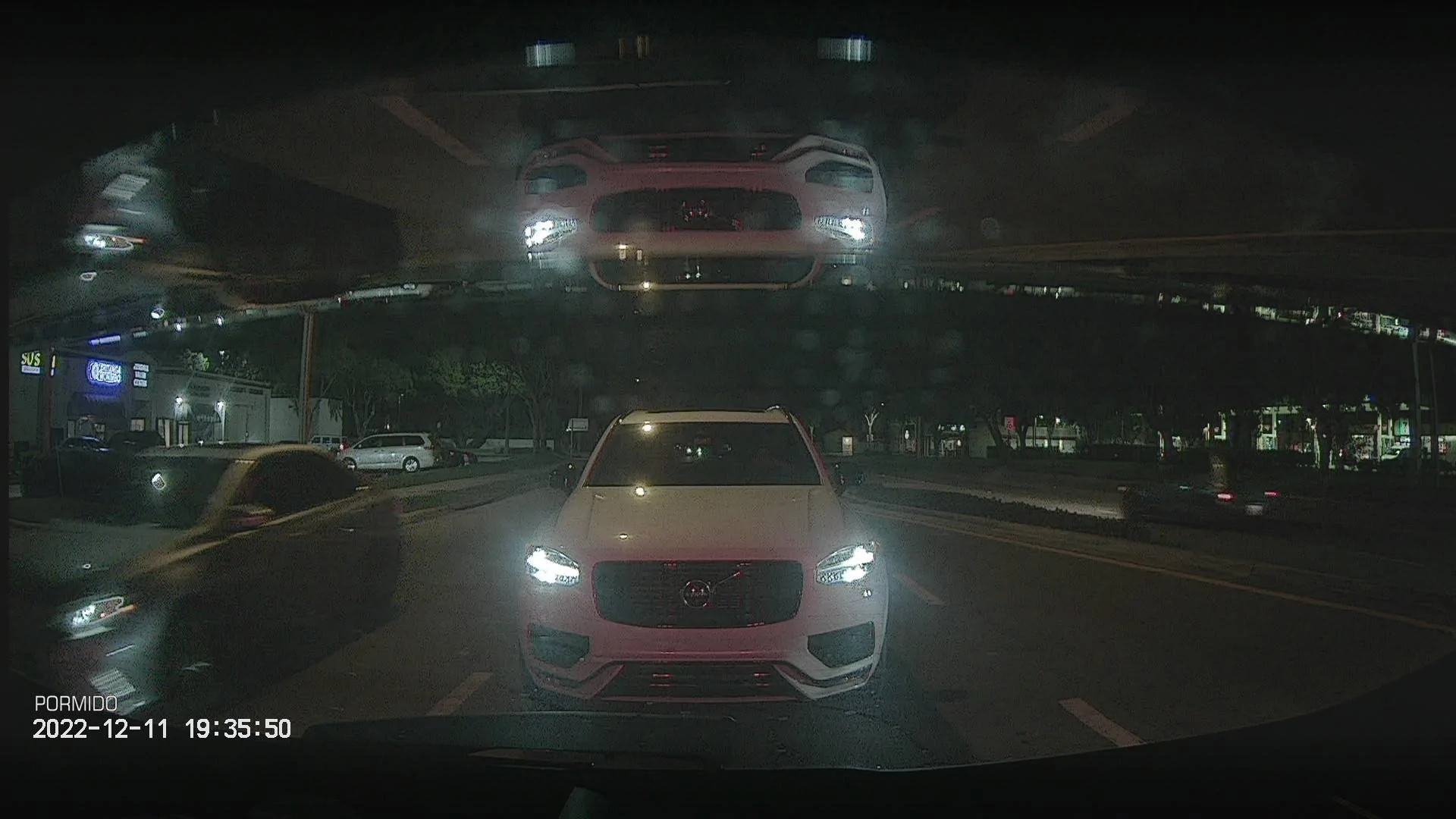

If the lady in the picture below rear-ended me while looking down at her phone or infotainment, I'd have a reasonable chance at providing evidence:
Ford Mustang Mach-E Digital Rearview Mirror Installed car detail
My rear glass is fairly dirty in these pictures and no tint film added to the factory dark glass. It's obviously not as clear as the shots I posted earlier from that YT review.
If your footage isn't as good as these, there are a few possible reasons.
  • Is your glass tinted and/or dirty?
  • Are you sure the product has a good and properly functioning sensor? I tried multiple products before settling on this one because it had by far the best WDR.
  • Does post-processing/enhancing the image (auto balance, etc.) help?
