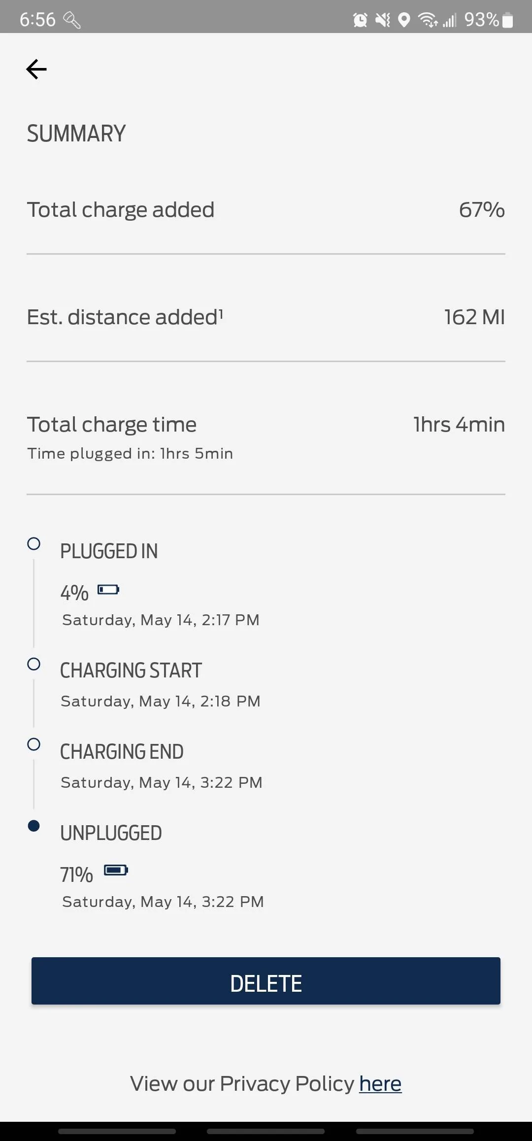

Yes exactly what Ford pass shows is what the dash showed. I even ended the charge session early when it said 71%/170ish miles so that another driver could use the charger as it was more than enough to get to the mid point where I was going to have to charge anyway. It'd be interesting if the reporting was off but that'd make the app and car wrong and of course I'd been over-charged at that point. I dunno. For it to recalculate the max range available (270ish to 230) it must have changed something in its calculation of some kind.
I got extremely low on battery due to never getting a chance to go to the supercharger, so does it rescale at all to help users not run out? Like is there a reserve battery used under 10% battery life or something and in reality filled that up vs the main battery and then recalculated this morning?
The other thing was that the supercharger quoted like 2 hours to get to 80% and 1 hour later or so I was already at 71%. I'll try and figure out some more info as I get it. All I know is that I charged up to 71%/170ish miles (as shown in the charge session) and that was reflected on the vehicle as well until I restarted this morning.

Another dumb question. Can you steal or transfer energy from a car? There's only one pay for charger within 20-30 miles of here. Didn't know if that would be possible or not.
I really feel like the supercharger or my vehicle was just displaying the wrong info and it didn't update til this morning. I can't make any sense of it otherwise. Or well I can't make sense of it with there being 0 other warnings, errors, etc.

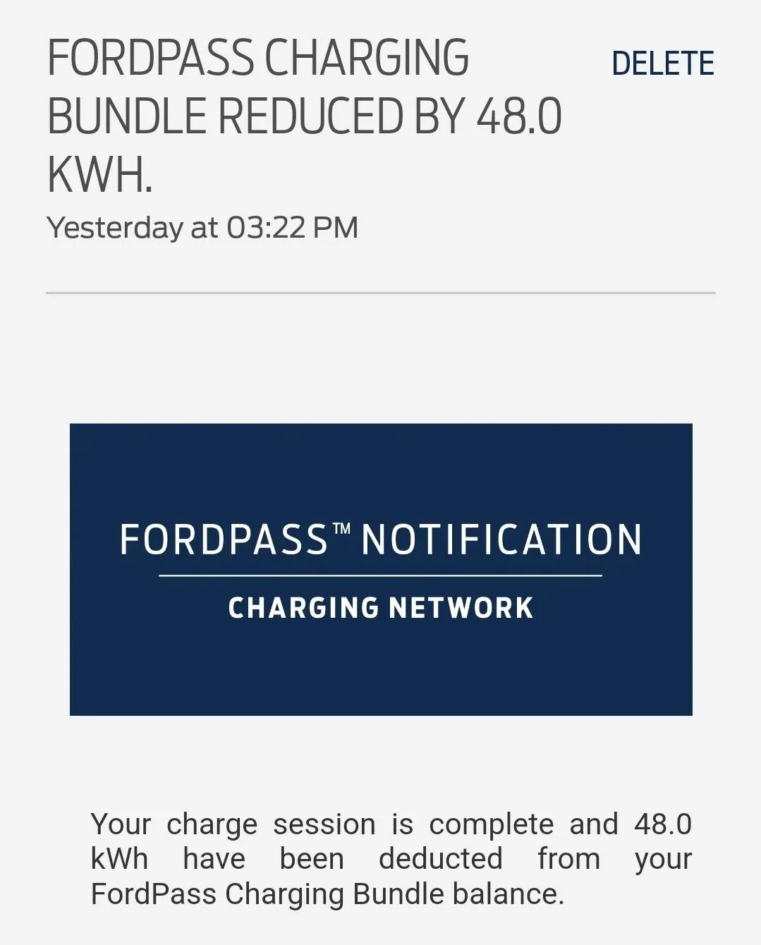

Here's another clue. My bill from Ford was for 48kw. It's a 88kw battery right so that's realistically around 54% of energy vs the 67% charged?
Ford Mustang Mach-E Dramatic range swings/changes overnight Screenshot_20220515-124832_FordPass
Ford Mustang Mach-E Dramatic range swings/changes overnight Screenshot_20220515-065658_FordPass
