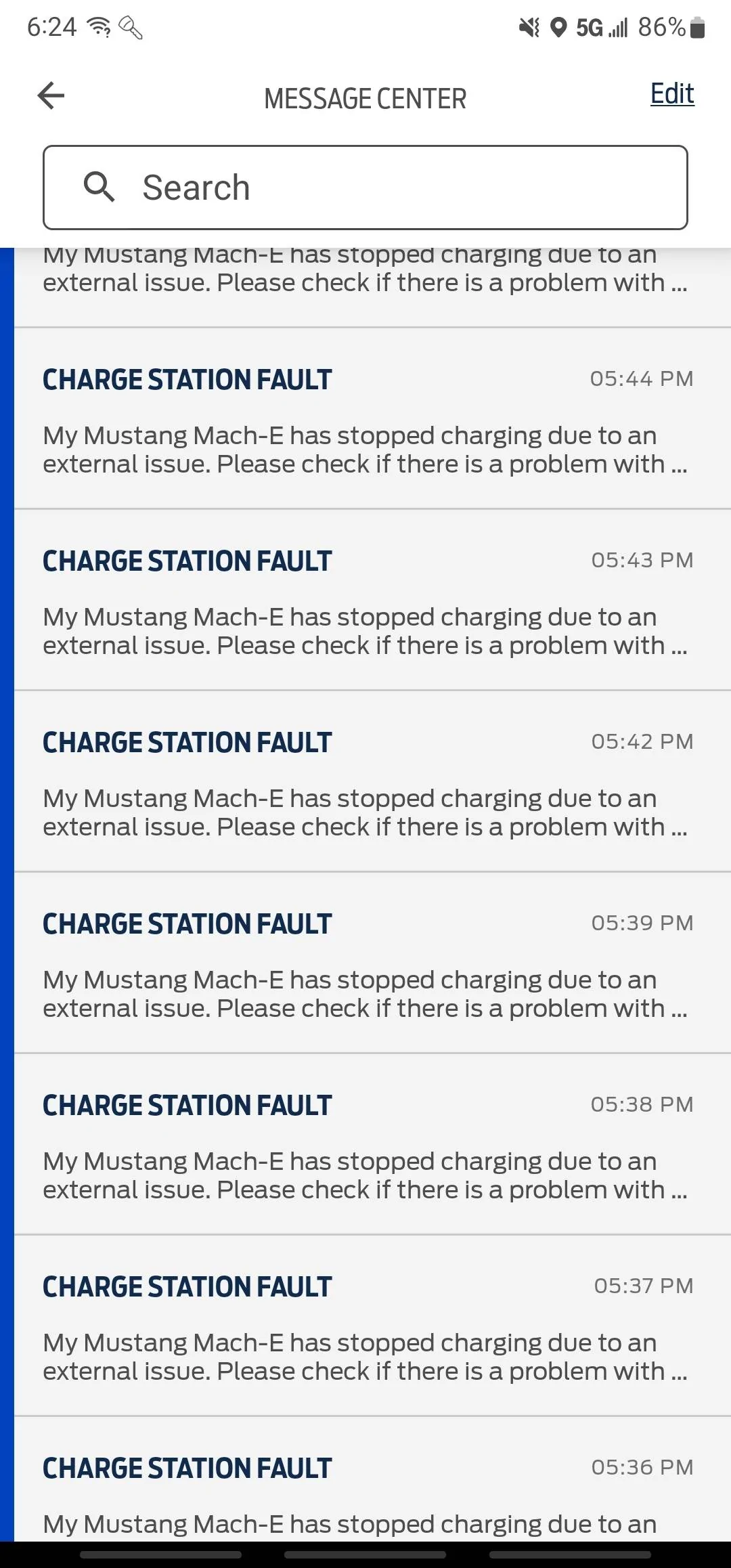

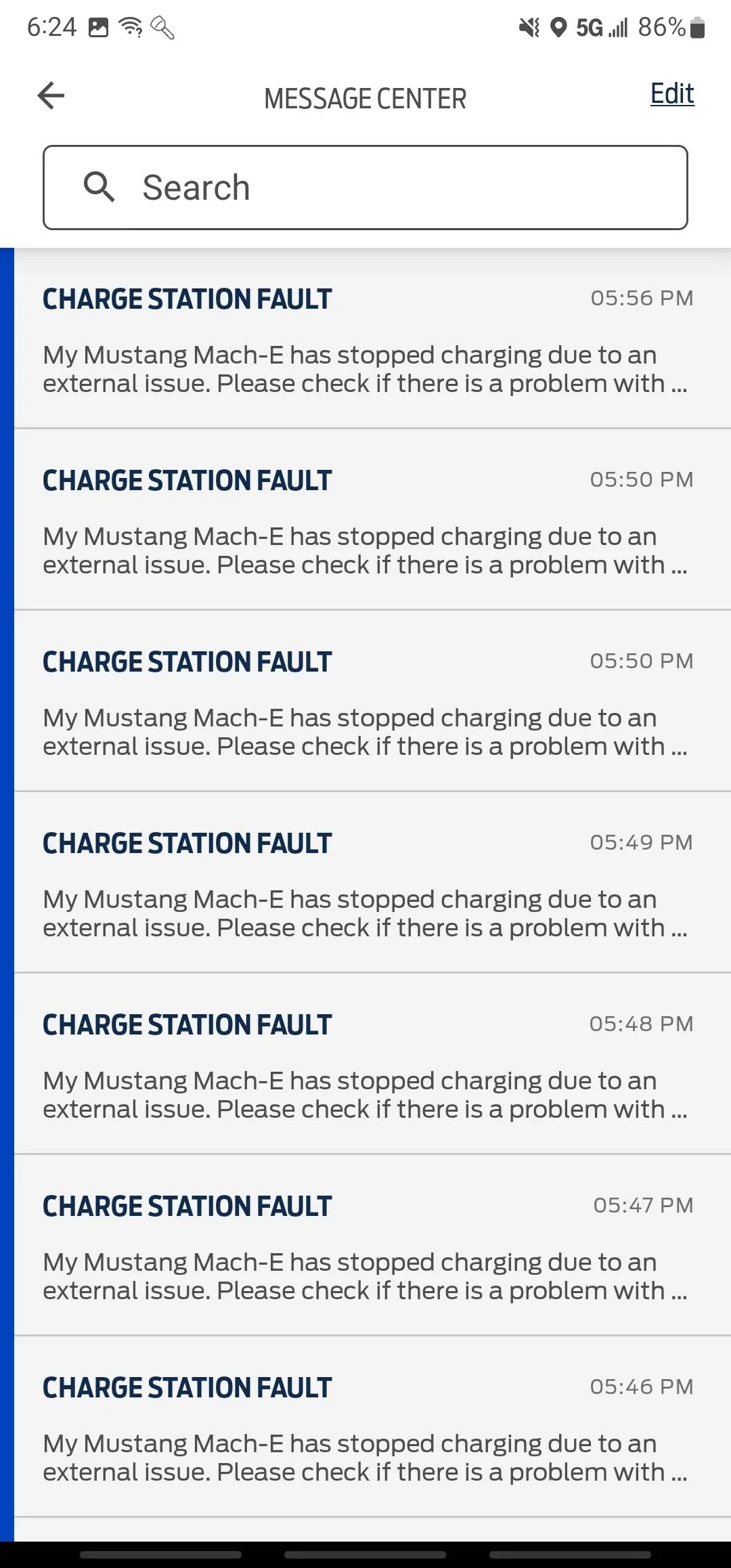

Still working with dealer, but man these charging faults are beyond frustrating and will end up getting us stranded. There's not a lot of fast chargers down here in the south, so it is definitely stressful for drill. Took over 40 minutes of tech support and trying 3 chargers to get one to work (Electrify America/Ford Blue Oval). Only gave around 30kwh of power on average on a 150kwh station. Kia EV6 rolled up in a station that wouldn't work with my vehicle and got full 120+kwh power the entire charge so it definitely isn't the station. Charged 20-80% in literal minutes whereas 40-78% took hour+ for me. Tons of charging faults/ DTCs thrown/etc.
Dealer already did numerous software updates, but what is the next step? They're not responding to emails, but I plan to just drive by again Monday when I am back home and off orders.
Has anyone had to replace any components and have success from that?
