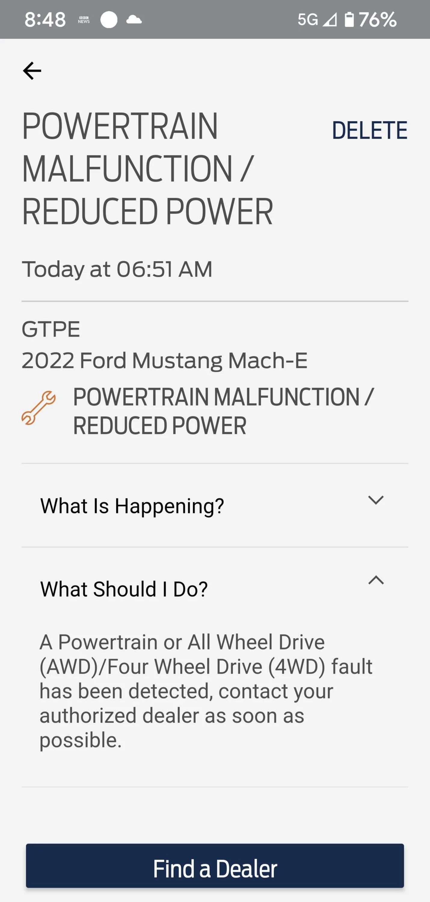

So I go to get in the car this morning and noticed that it didn't pre-heat/condition, so ok. Start and get Service Vehicle Soon with a nice gold wrench. Car did turn on but decided to grab the wife's CRV. Then after I got to work, go a notice on the Ford app.
Ford Mustang Mach-E Dreaded Service vehicle soon Screenshot_20230203-084803
I did notice when I first turned it on, it almost sounder like an ICE vehicle when the 12v battery is bad( excessive clicking). Would this notice put up for a bad 12v?
Thanks-- Jay

That is not the HVBJB message, so it may not be that bad. See if when you start it the message clears.
Clicking is normal since a recent update.
Thanks Rick, I'll check it/try it again when I get home.
I did just get the 4.1.2 update yesterday or wendsday.
11,396
23,058
SVS and SSN message occur for a variety of reasons including, but not limited to, the dreaded HVBJB failures. In fact I got a SVS myself on Tuesday when my car was parked and charging on a 32 amp L2 evse at home. See what happens after doing a power cycle on the car and leaving it off for awhile.
