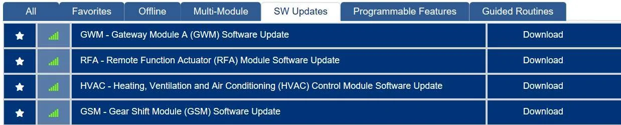

I had that issue with my lift gate and I just had 21P22 installed today and it’s working again. @generaltso, could you please run my vin to see if they applied all of what that update was supposed to be applied to?
This is what you still have available. I think the only one of these that's technically part of 21P22 is the RFA.
Thank you very much! You wouldn’t happen to know what that update would entail? Lol. Just curious to see if it’s even worth going back to have them address that.
