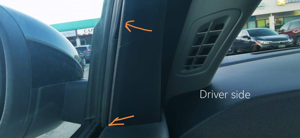

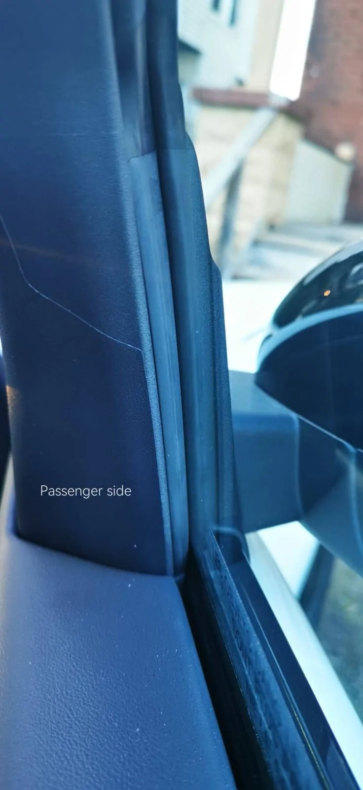

Buddhika
Buddhika
Mar 13, 2024
Canada
Ford Mach E
I have Mach e 2023 CR1. I am having a Hissing sound from the driver's side. Went to the dealer and they said it was because of air leaking from the A-pillar as per TSB 24-2002. Ordered parts from the USA and fixed but the problem persists. It's annoying while driving and disturbing.
Ford Mustang Mach-E Driver's side window has an air leak. WhatsApp Image 2024-03-28 at 9.35.59 PM
Ford Mustang Mach-E Driver's side window has an air leak. WhatsApp Image 2024-03-29 at 10.56.59 AM
