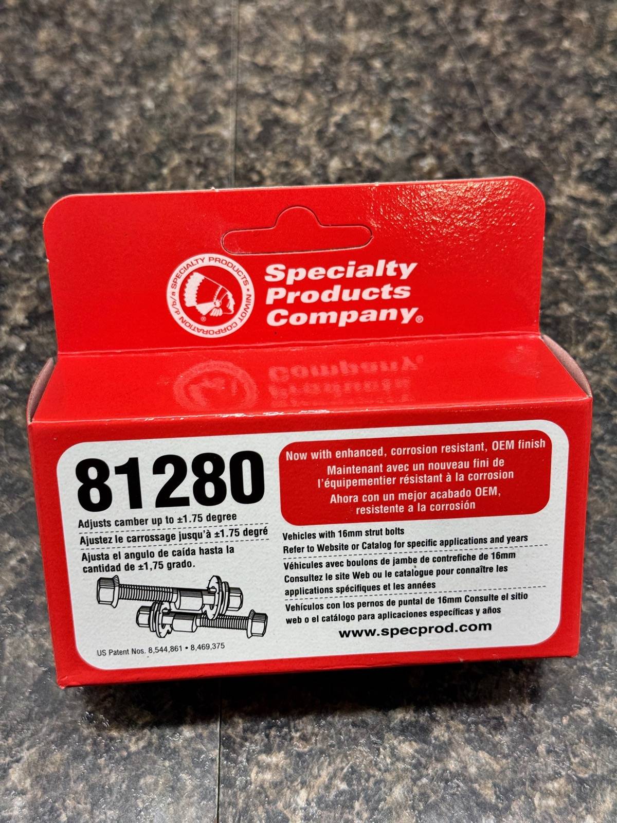

Do must alignment shops have adjustable camber bolts on hand or does the customer need to hunt down the specific ones and provide them? Wasn't sure if they were all sort of universal.
markboris
Nov 13, 2019
43
5,731
16,371
Sonora, CA
Hey guys how much was the camber off on your alignments? Just wondering if the adjustable camber bolts are recommended of if the alignment is only off slightly that won't really cause an issue.
As far as the rear goes, it is adjustable from the factory and so far the 5 cars I have installed the lowering springs, all have been able to be adjusted no problem within factory specs. The fronts are not adjustable at all unless you 1. replace the upper splined bolt with an adjustable bolt leaving the lower splined bolt in place or 2. replace both splined bolts with regular bolts (5/8" bolts, 3" long grade 8).
These are the adjustable camber bolts for the front if you want to go that route instead of regular non-splined bolts. You only need one set.

Those are what I'd love to find for the rear. -1.9 to -2.0 is just within spec on the rear so it works without having to cam the rear.
