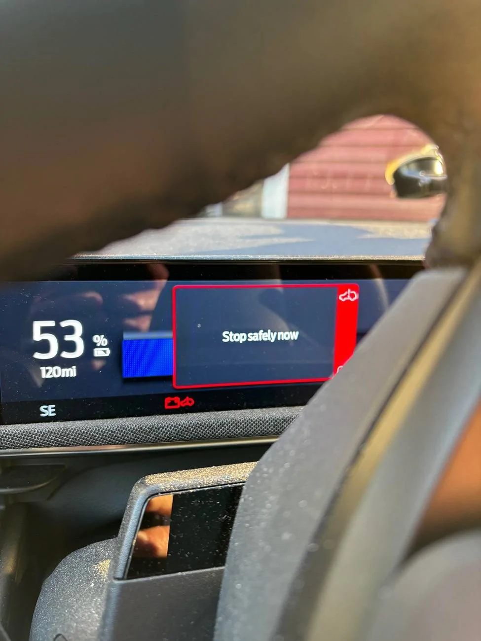

These lights came up when I started my 2023 Mach e. Can anyone tell me what problems I may be looking at? Thanks

The car is warning of a battery problem. Possibly the 12V having an issue. It’s impossible to tell without pulling codes. Maybe @Mach-Lee @Mike G or @rugedraw can find your DTC(s). ??

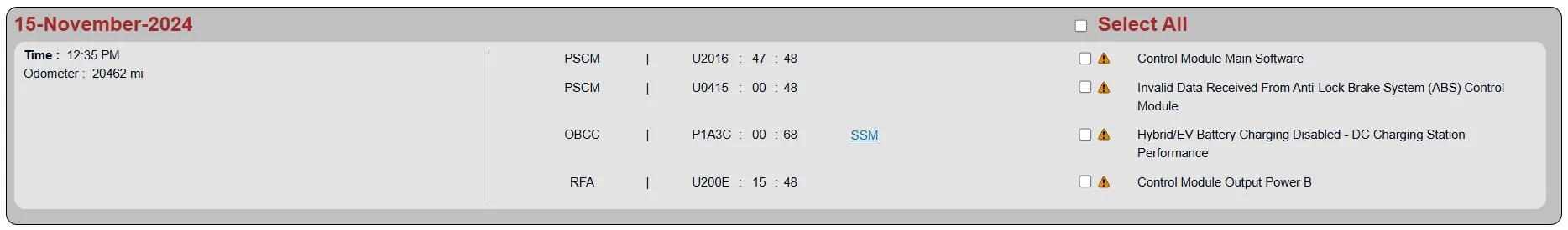

@Prdnk These are the codes the car last reported. These codes do not indicate a hard fault code on the dash and are not new......you car has been reporting them for about a month. I don't think this is what caused the stop safely message. It is possible that whatever caused that to happen has not been reported to the cloud yet. It's hard to diagnose these things without being able to plug into the car directly.
Ford Mustang Mach-E Electrical issue: Stop safely now 1731705678504-pi
Have you tried starting and driving it again to see if the code is still there? Maybe that'll force it to report the code to the cloud and I can check again to see if anything new shows up.

Just started car. Codes disappeared. Thanx. Will schedule a service to just have it checked out. Thanks for the help!
