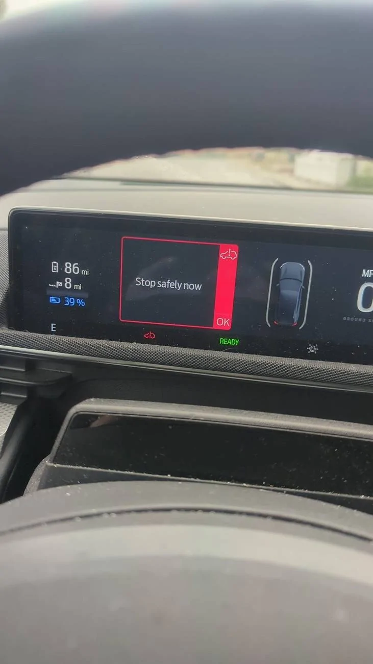

My wife just got the dreaded SSN message while driving. She was able to drive home. We have a 2022 SR RWD and haven't had any issue except for Pre-collision assist error that came and went a few months ago with the dealer refusing to repair. Don't know if it's HVBJB, it's rare for SR RWD to have HVBJB issues. Would anyone be able to check for this new error code for us?

Sorry to see you going through this. Go to the FDRS thread and post your VIN. Ask for the volunteers to look up your car’s Diagnostic Test Codes (DTCs). ??

I'm just seeing a lost communication code with BECM. If you turn the car on now, is the error still present? If not then you're good and don't have to bring it to a dealer.

I turned it back on and it's gone. Pheew thanks!
