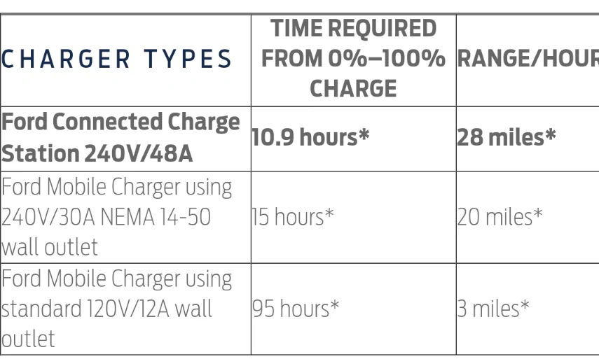

I'm expecting to take ownership of my MME June 30th and prepping the garage charging. I plan to use the charger it comes with and my electrician is questioning the specs I requested based on this table from the ford brochure. It says 240/30A NEMA 14-50 outlet. He is saying that the NEMA is for a 50A circuit so why am I asking for a 30A circuit. What specs do I need to use the supplied charger? I'm very out of my league here.

You should have wiring capable of handling up to 50 amps hence the 14/50 plug. The charger uses up to 32 amps so your electrician would put a 40amp breaker. If ever you change to an EVSE capable of 40+ amps you can just have the breaker swapped out. As for the wiring, I have always felt that if you do something do it right. Copper all the way. I still don't trust aluminium wiring and with such a large amount of current draw I'd stick with copper. At the end of the day if you can pay for it and the difference in cost doesn't bother you then pay the extra.

That's a misprint. You need a minimum of a 40A circuit on a NEMA 14-50 outlet, but the "right" way to do it is to run a 50A circuit. The mobile charger only draws 32A, but because it is a continuous load for more than 3 hours the circuit itself has to be rated for 25% more than what the charger is actually going to draw. So, for a 32A charger the circuit must be at least 40A. While you can connect a 14-50 outlet to a 40A circuit, the cost difference in running a 50A vs 40A is not very much. By running a 50A circuit if you replace the Ford mobile charger with a 40A charger (that charges 20% faster than a 32A) you will be all set.

Your electrician is correct. The Ford Mobile Charger draws ~32amps, and circuit breakers can only handle 80 percent of their rating, so a 40 amp breaker X .8 =32 amps is the MINIMUM you need. Likely 99% of people install a 50amp circuit just to have a safety margin. The "50" on 14-50 means the outlet is rated for 50amps. If you go aluminum, I would absolutely go with a 50 amp circuit.

Your electrician needs to install wiring and a breaker that handles 50 amps for your NEMA 14-50 outlet.
The car is not permitted to pull more than 40 amps when using that receptacle. This is because the National Electric Code defines any load that can last longer than 3 hours as a "continuous" load (and charging an EV can easily take more than 3 hours). Circuits supplying a "continuous" load must be rated to handle 125% of the load (so 125% of 40 amps is 50 amps). OR ... another way of saying it is that no device should pull more than 80% of what the circuit was designed to handle.
The Ford Mobile Charger that comes with the car only pulls 32 amps ... but you may decide to get another charger someday and you'll want to know that your receptacle (rated for 50 amps) really has the wiring to handle it without risk of overheating.
