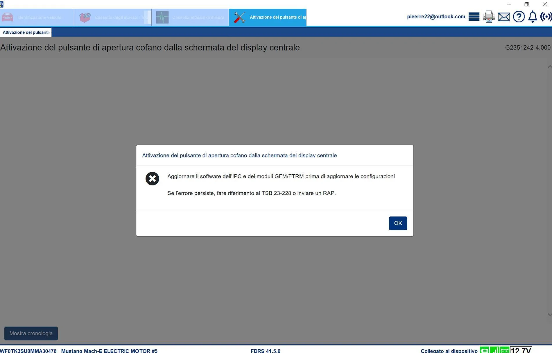

after about a month of reading and various tests I decided to ask for help because honestly I don't know what else to try. I've been trying to activate Frunk for a long time both from the "sync 4" tablet and from the key, but unfortunately with always failed attempts.
Using Forscan I only managed to make the button appear on the display, but in fact even if I press it it doesn't work. It has become a question of principle for me, it is not possible that something so stupid can be so complicated.
There is more and more on the forum, but there is no clear guide on how to perform this procedure. Many refer to activation via FDRS, well I tried this too (I state that I have all the updated modules), but I have this error result that you see in the attached screen.
Does anyone have any idea what the problem could be?

The first is that I still cannot activate the opening of the frunk front panel either from the display or from the keyboard, every time I tried to enable it through FDRS I always got the error in the image you see in the previous message where the instructions of the TSB 23-2281 bulletin are recalled.

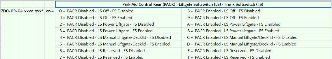

Assuming the a/b on Ford's side is correct:
Ford Mustang Mach-E ERROR ACTIVATING FRUNK WITH FDRS 1731096044742-rs
Your frunk soft switch is disabled. Try:
xxxx xxx3 xx--
Looks like it's worth a try.
xxxx xxx3 xx--
rugedraw you are great, made the modification with forscan the icon appeared and now it works perfectly from the display.

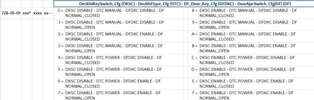

Ok good.....half way there. Maybe this? (not sure)
Ford Mustang Mach-E ERROR ACTIVATING FRUNK WITH FDRS 1731178530157-p9
And/Or here?
Ford Mustang Mach-E ERROR ACTIVATING FRUNK WITH FDRS 1731178559785-0t
And/Or here?
Hi, I have tried all these things but with no success. When I changed the value indicated in some cases just written, the driver's door came out open even though it was closed. For the rest, however, nothing, when I tried to open it with the remote control key nothing happens.
