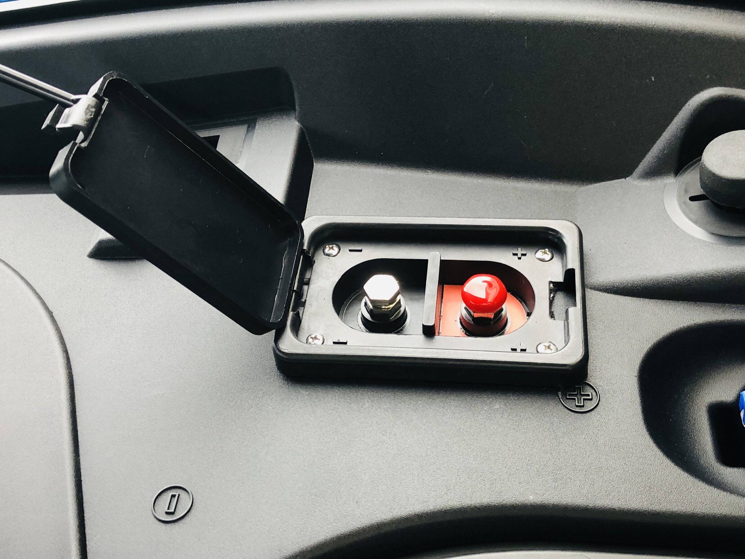

Cut the access holes so you don’t have to take the panels off to reach the power points next time.
I was able to carefully cut my holes without taking the panels off even once. Follow the excellent diagrams provided on the other thread.
Or do this:

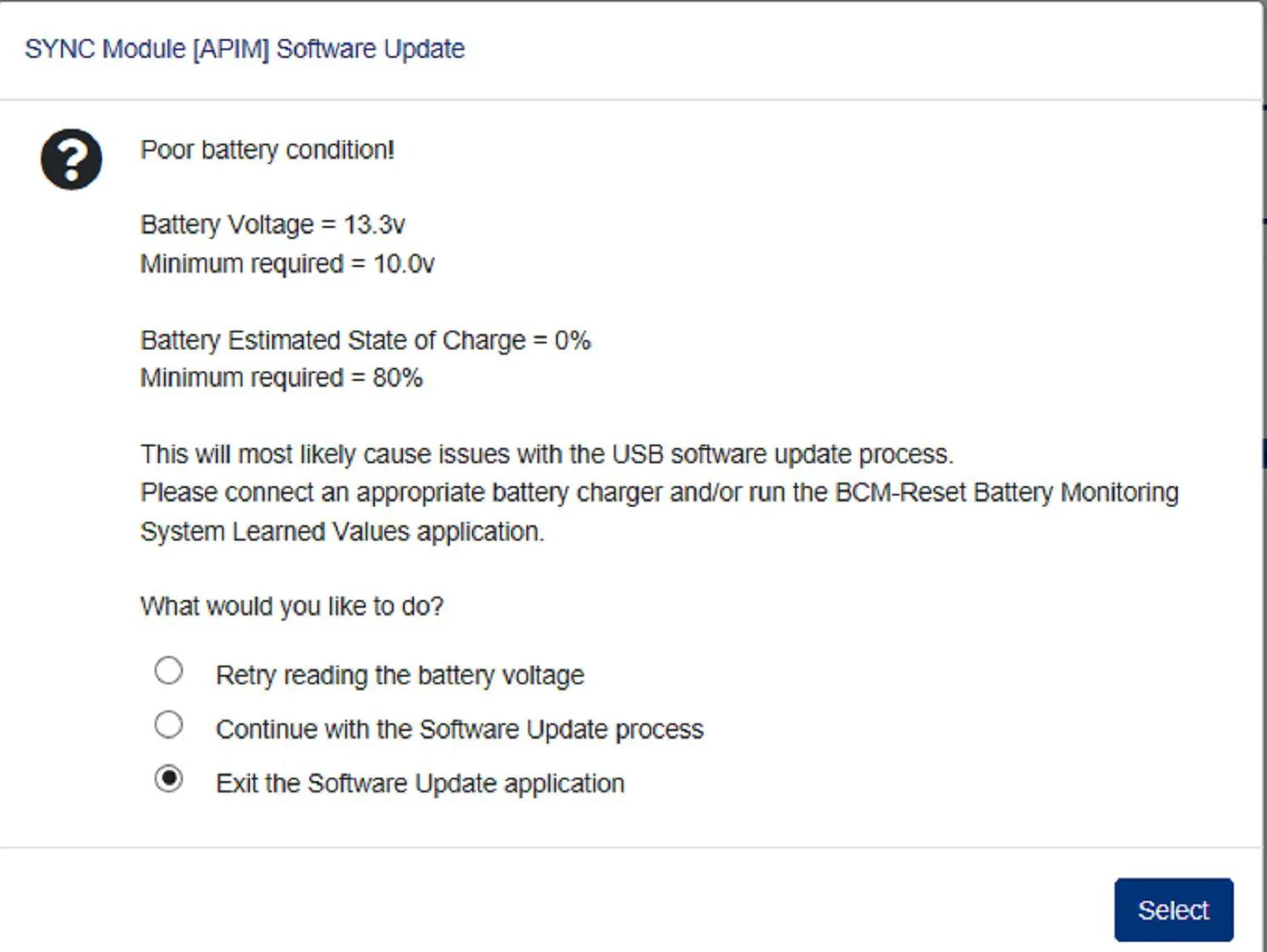

So I decided to take the plunge and bought everything needed to do updates myself. Things have been going smoothly and was able to get myself unstuck from 1.7.1 OTA. I then continued onto the next module APIM/Sync and after 1.5 hrs this error came up. The battery has never gone below the 13.4 while on the battery supply. My HVB is at 69% and I do not have that plugged in as I didn't think it would need to be. Do I need to get above the 80% charge?
Or is this just a warning, and I can just continue since I have everything setup and battery never drops below...?

I have a new view on this error. But, first in this specifice case - it was probably caused by the incorrect ground connection, so see if you get this error again with the correct negative post connection, that others have explained.

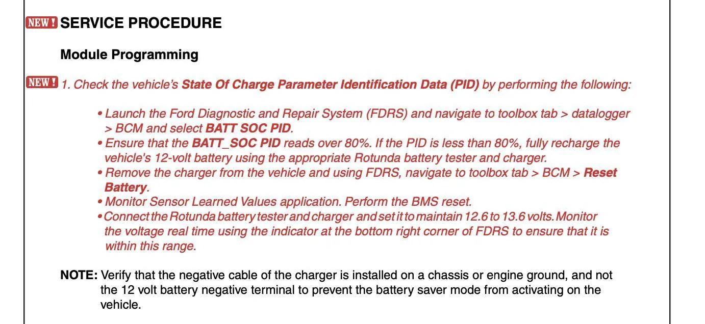

The following is from the revised 21G01 procedure posted May 4, 2022 Added updated technical info instruction sheet 21G01 by @benk016.
However, for those who get this type of error with the proper jump point connections, I would perform this simple revised Ford procedure first (no matter how big your power supply is) before proceeding with your FDRS programming session:
1. Check the vehicle’s State Of Charge Parameter Identification Data (PID) by performing the following:
• Launch the Ford Diagnostic and Repair System (FDRS) and navigate to toolbox tab > datalogger > BCM and select BATT SOC PID.
• Ensure that the BATT_SOC PID reads over 80%. If the PID is less than 80%, fully recharge the vehicle's 12-volt battery using the appropriate Rotunda battery tester and charger.
• Remove the charger from the vehicle and using FDRS, navigate to toolbox tab > BCM > Reset Battery.
• Monitor Sensor Learned Values application. Perform the BMS reset.
• Connect the Rotunda battery tester and charger and set it to maintain 12.6 to 13.6 volts.Monitor
the voltage real time using the indicator at the bottom right corner of FDRS to ensure that it is within this range.
NOTE: Verify that the negative cable of the charger is installed on a chassis or engine ground, and not the 12 volt battery negative terminal to prevent the battery saver mode from activating on the vehicle.

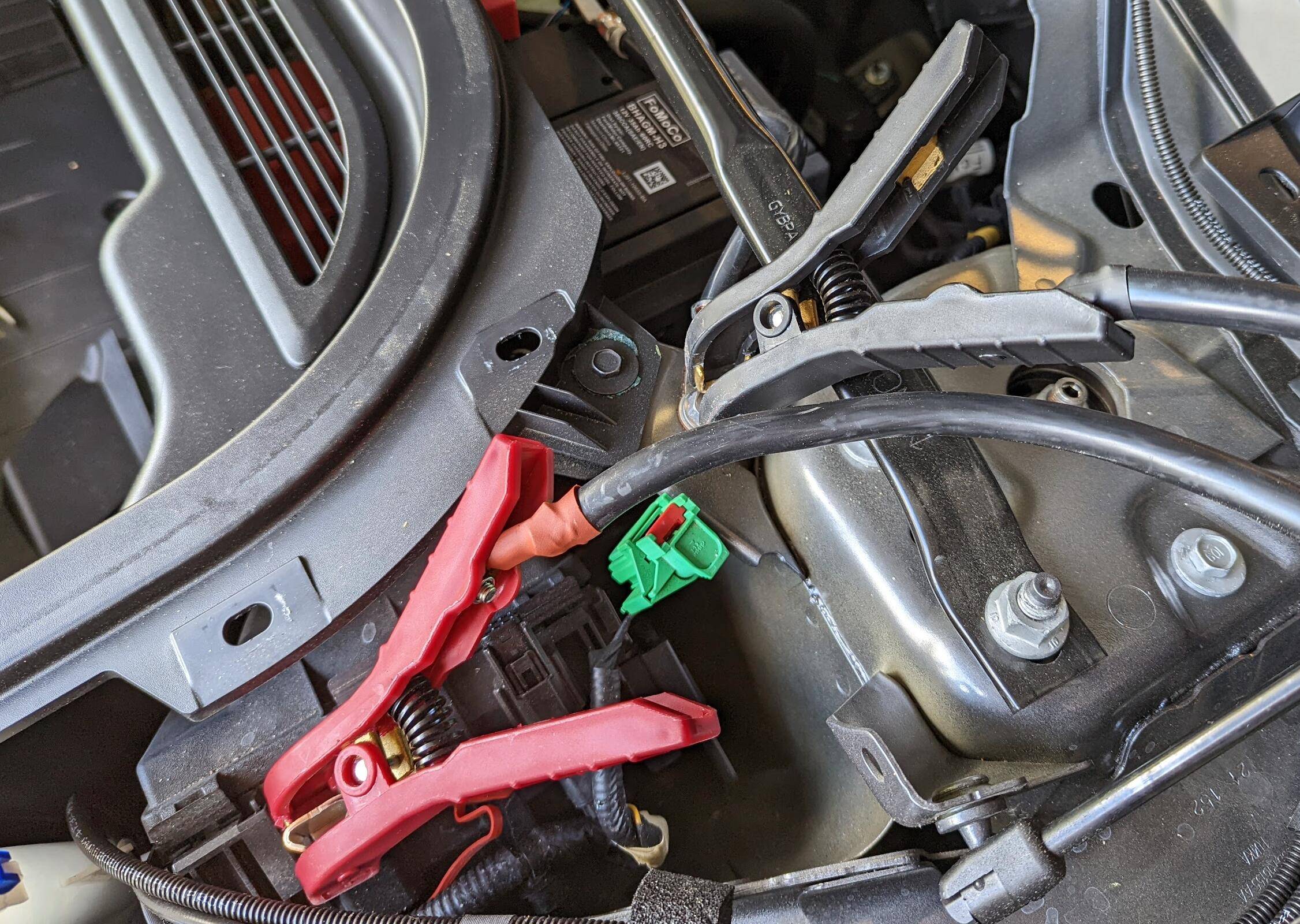

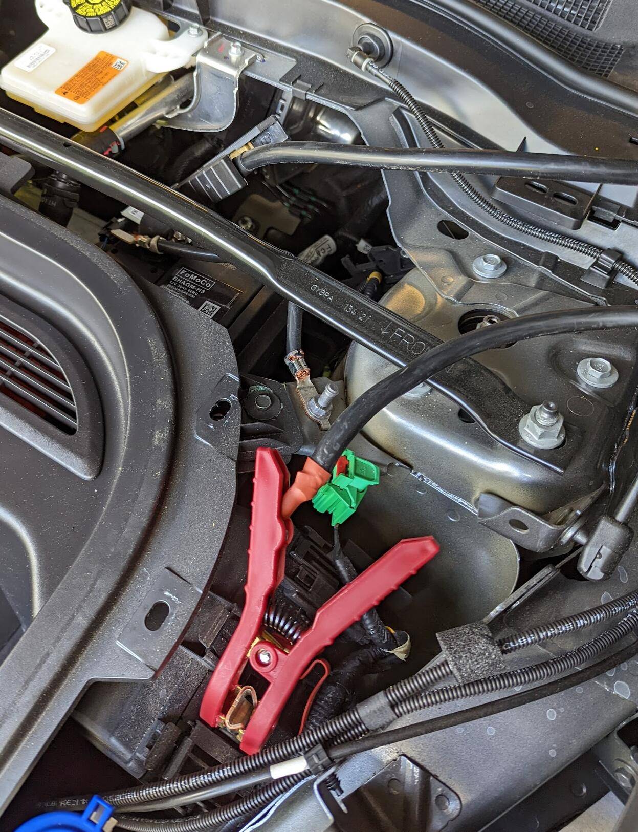

Do I not have this hooked up correctly..? Been doing updates since 8:30am and the battery supply and FDRS never showed it below 13.4V
Bad hooking up this way, BMS will force load shed and shut down modules because it thinks the battery is dead. That will definitely ruin you day programming. % should come back up slowly after fixing the cables, if not reset the BMS.
I did this and it worked well!

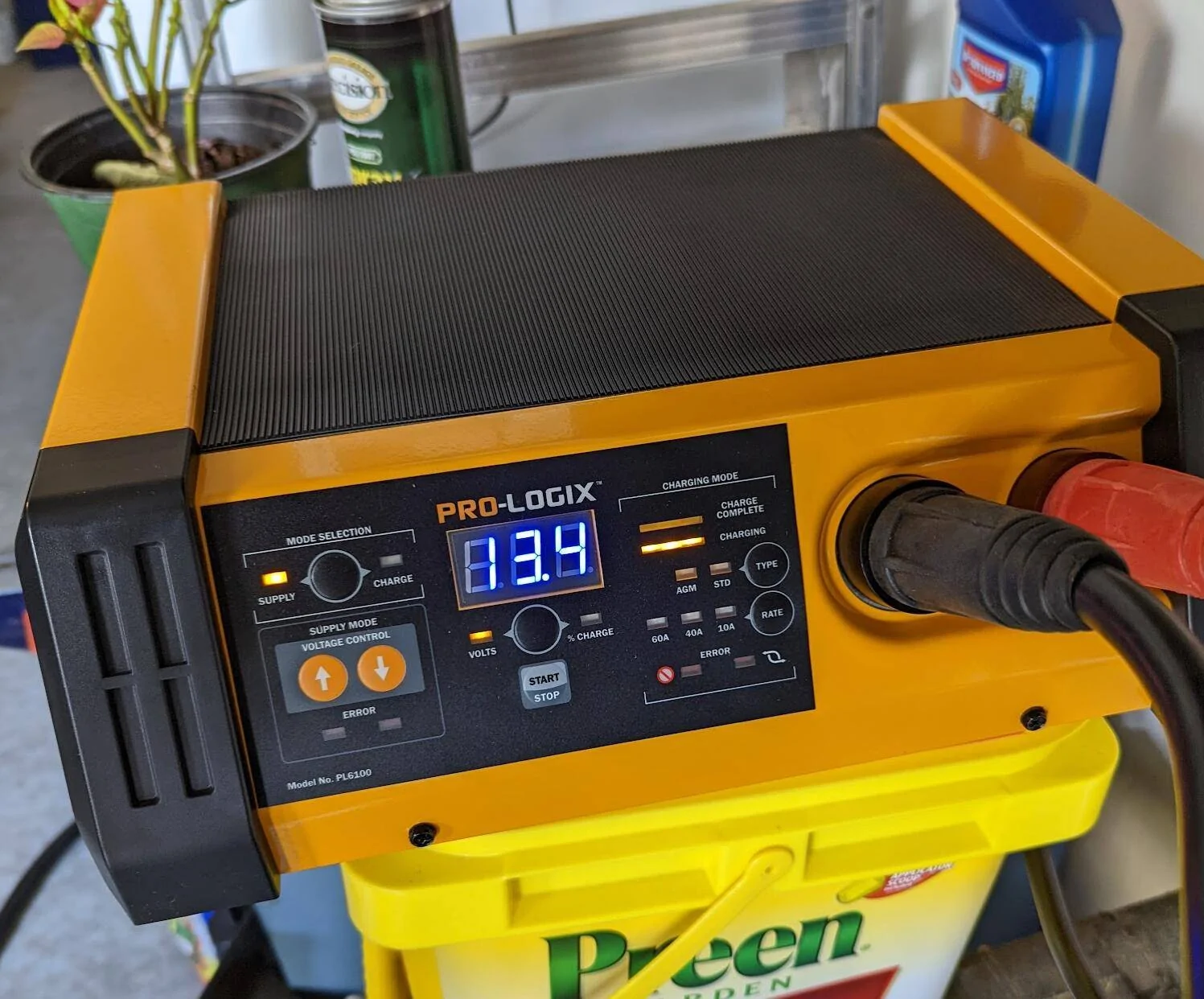

Turn everything off, then connect the PL6100 in the PS "Supply" mode (not charger mode) set to 13.4V, positive and negative cables to the jump posts. Now if you start FDRS, do you still get the battery error?
