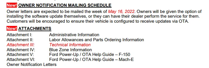

Note: Something handy for all of us.
BlueZone. The full BlueZone interactive map is expected to be available in
May 2022.

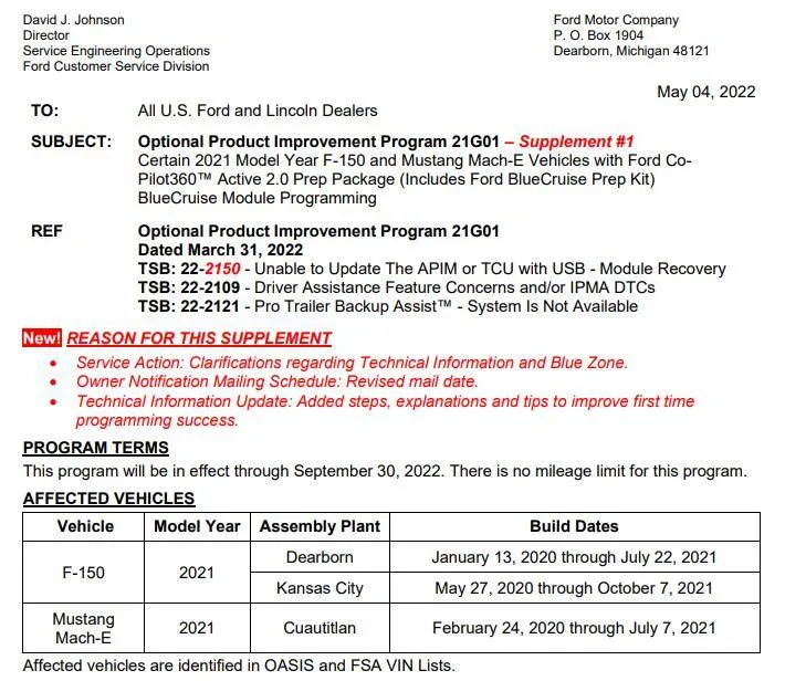

Also, there is this new note on 21G01
May 3, 2022 – NOTE: There is a known issue when 21G01 is performed, where the Mach-E Front Luggage Compartment controls in the infotainment display screen will be inoperative until a future software update is available. The manual lever in the driver footwell will still be operational.

Added updated technical info instruction sheet to First Post, and also here.
