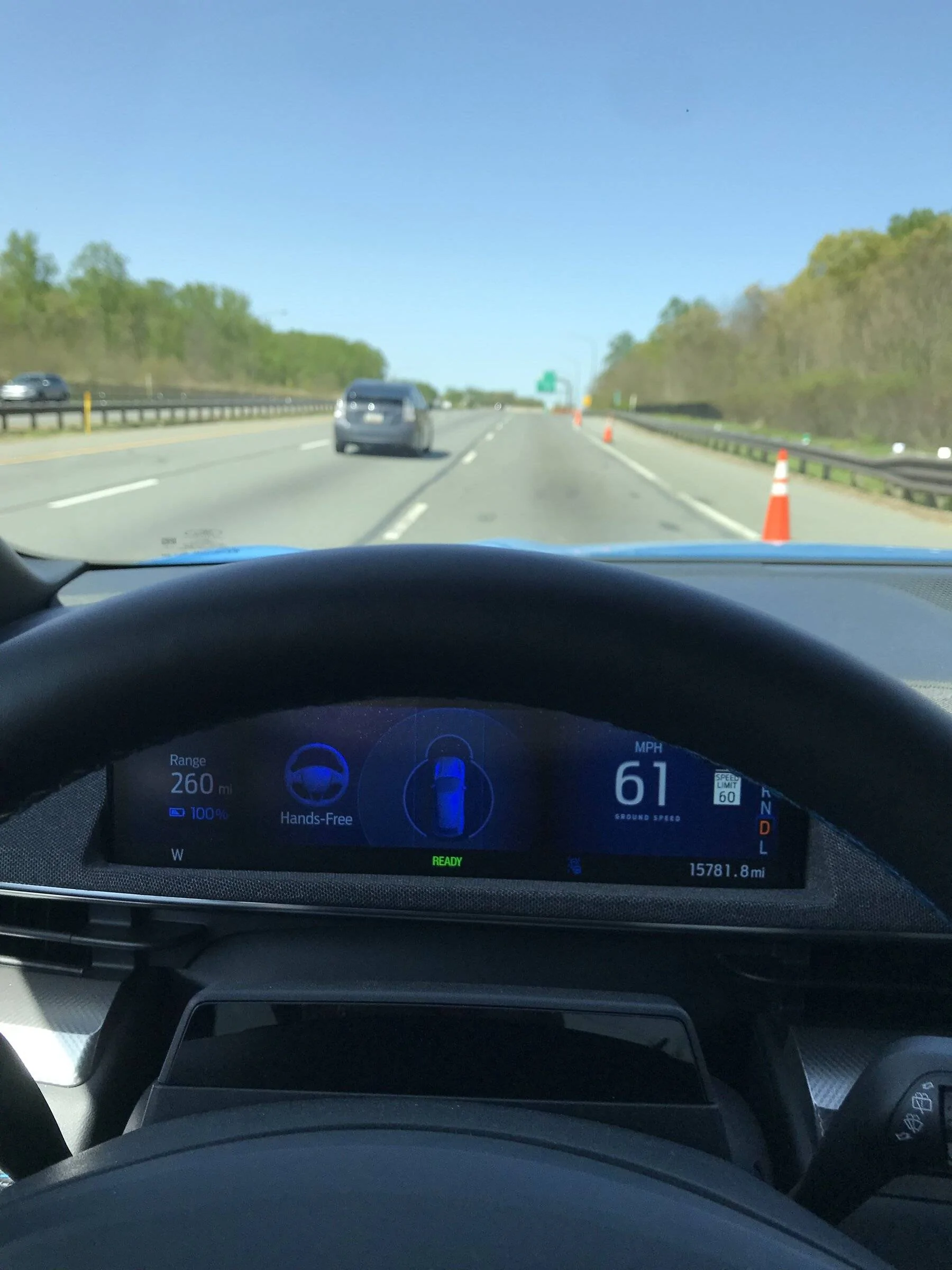

Koons Ford Silver Spring, with the help of a Field Service Engineer and folks in Dearborn, have been able to get 21G01 to work properly. Marlin now has operating BlueCruise. My wife sent me this picture:
I'm looking forward to getting home and trying it for myself.
