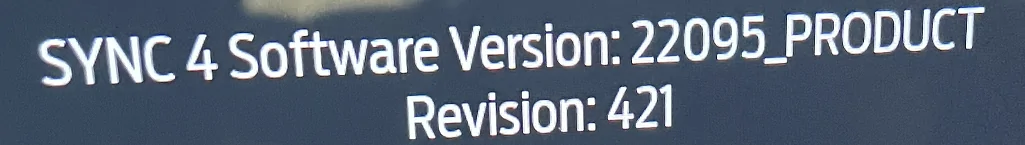

Could someone run my VIN number in preparation for my second attempt at BlueCruise at the dealership? Want to provide them with a list of things I’m hoping they remedy before giving me the car back. Seems like the new sync is 421.

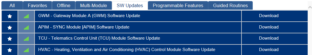

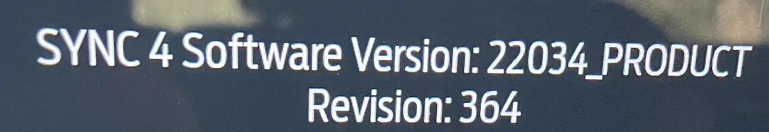

Updates are done (APIM, HVAC, GWM, and TCU). Nothing blew up.
Old Sync Version:
New Sync Version:
No obvious changes (yet).

So I haven't actually test driven BC yet but I was stuck on the 1.7.1 update and did the module reset TSB and then all of the updates in my garage with FDRS and a Mongoose adapter (and a HAM radio power supply @13.8V), and am now at Sync 364 with the expected options in the menus for hands free. I need to check on an air leak on my tire before I take it out, but it feels good to be updated. It took about a day and a half to get all of the updates done with a few breaks in between, but 1.7.1 was my last OTA and the last update performed by a dealer was over a year ago, so...
