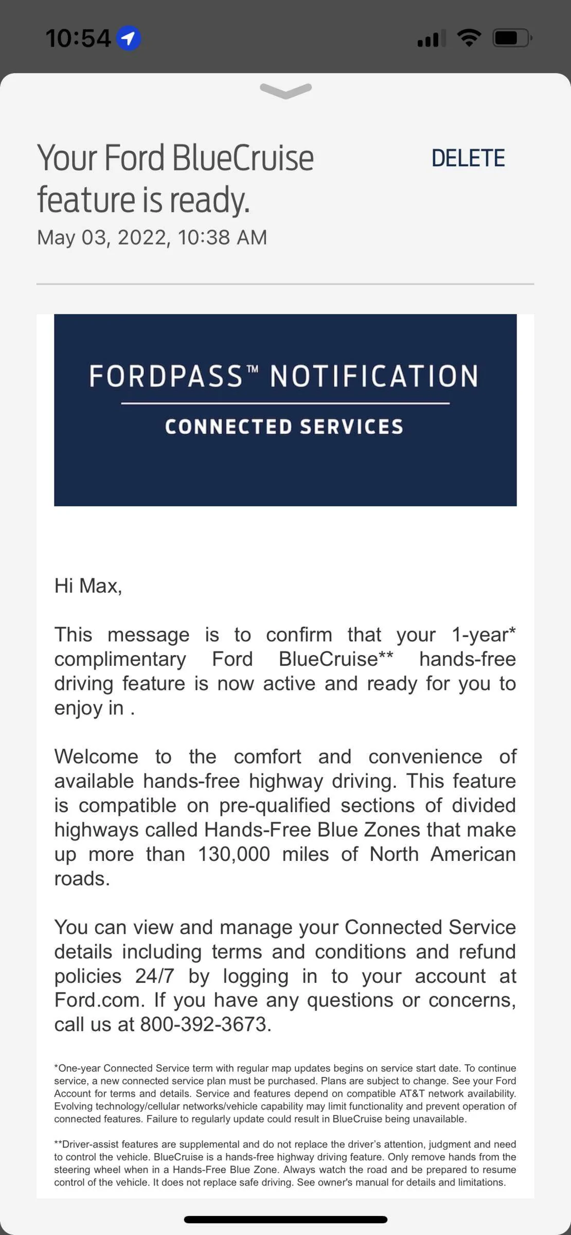

Great news! My dealer did the new IPMA update yesterday and this morning I got this :)
I instantly got the email about it too; I haven't picked up the car yet, but it smells good!
Insist that your dealer road-test it before you pick it up to make sure hands-free works. I received that message but it turned out it wasn't actually activated on the server side despite receiving the FordPass message. Hopefully that bug is corrected now on their end.

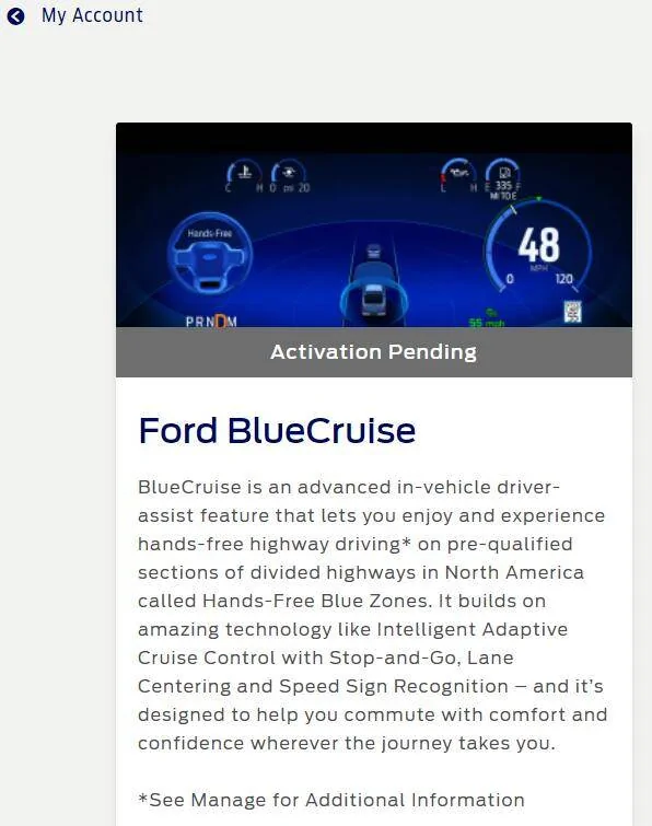

Did you just take that screen shot? Bluecruise just completely disappeared from ford.com for me

Asked my dealer. I did get the update from him and BC works great. Have not seen anything on website or app about it being "activated". Is there some type of notification dealer should do with Ford?
267
17,926
27,921
No. If BlueCruise works, i.e. you can drive handsfree on the BlueCruise roads, then you're all set. Don't worry about what a website says or doesn't say.

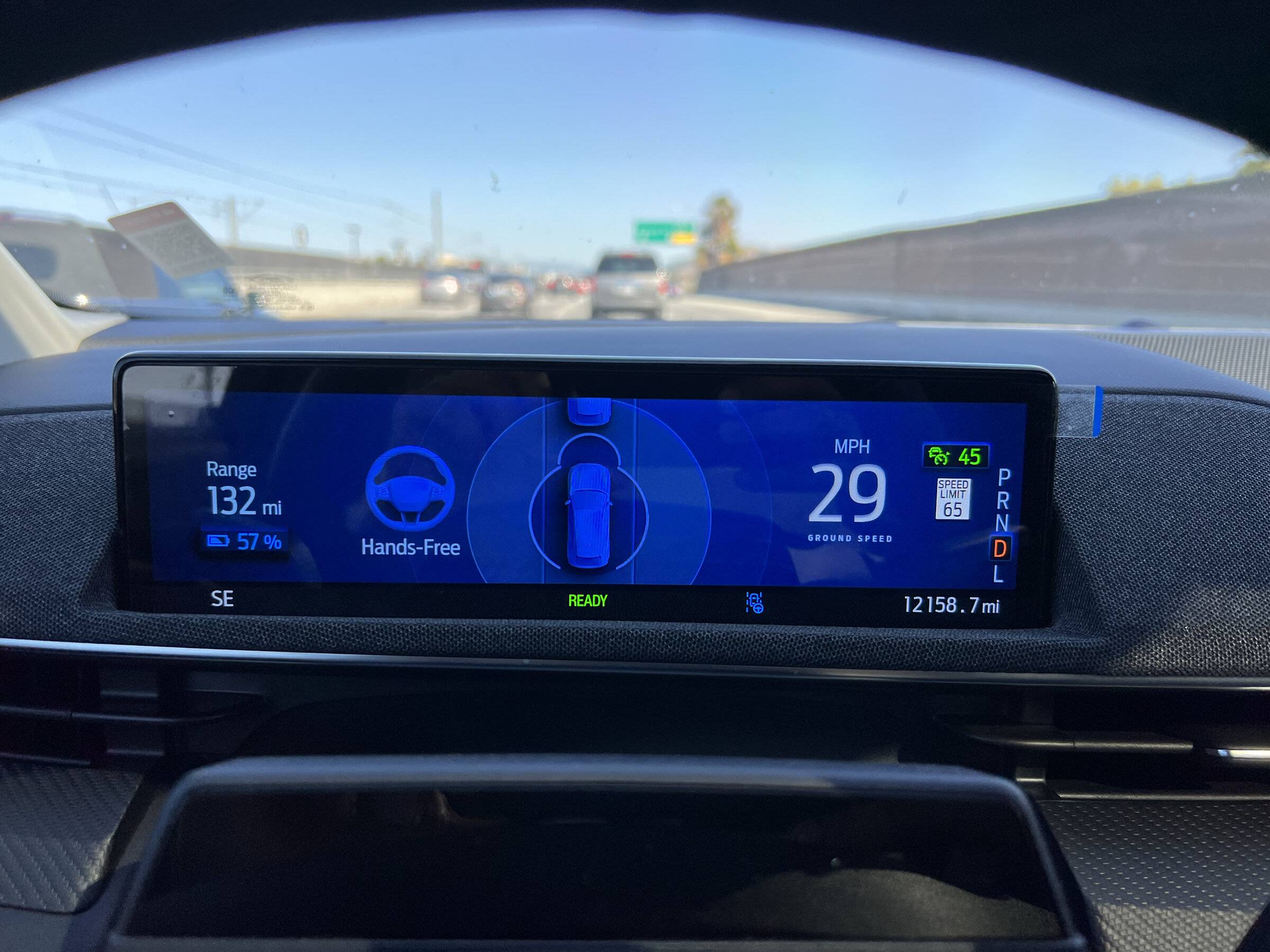

I guess I had the best-case scenario for attempt number 2 at the dealership. Got the notification this morning at 10:30am that my BlueCruise was active. It's now in Connected Services and just picked up the car and used it on the way home. Worked really well. Glad this saga is over.

The odd thing though, is under Conneted Services, bluecruise completely disappeared. No prompt in fordpass about activation either. I called Ford and they said the dealership has to add the 1yr service under my account. Called the dealership and they thought I was speaking another language and said maybe it's a question for the sales team... Called Ford back and they refused to help me saying if the work was done at the dealership, they have to figure this all out.
Is this an issue if it's not in Connected Services...? Back door and I can keep it forever?? :)
