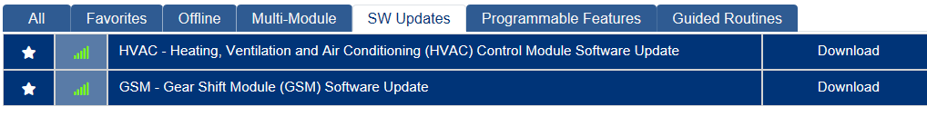

Could someone post what modules are available for my vin? Looks like they stopped working on it again and test drove. They havent called yet but I want to know what to expect. 3FMTK2R70MMA36353
benk016
benk016
Ben
Nov 12, 2020
3,284
5,133
Tulsa, Oklahoma
2021 Mustang Mach-E GT
Can someone post what modules are available for my vin? Looks like they stopped working on it again and test drove. They havent called yet but I want to know what to expect. 3FMTK2R70MMA36353
This is all that is showing for your car currently. Neither of which are needed for BC.
Ford Mustang Mach-E Optional Product Improvement Program 21G01 - BlueCruise Programming 1651851265066
However, PTS is still reporting this is your sync version: SYNC4 v4.0.21233
Hopefully that just hasn't updated yet and everything is good.
