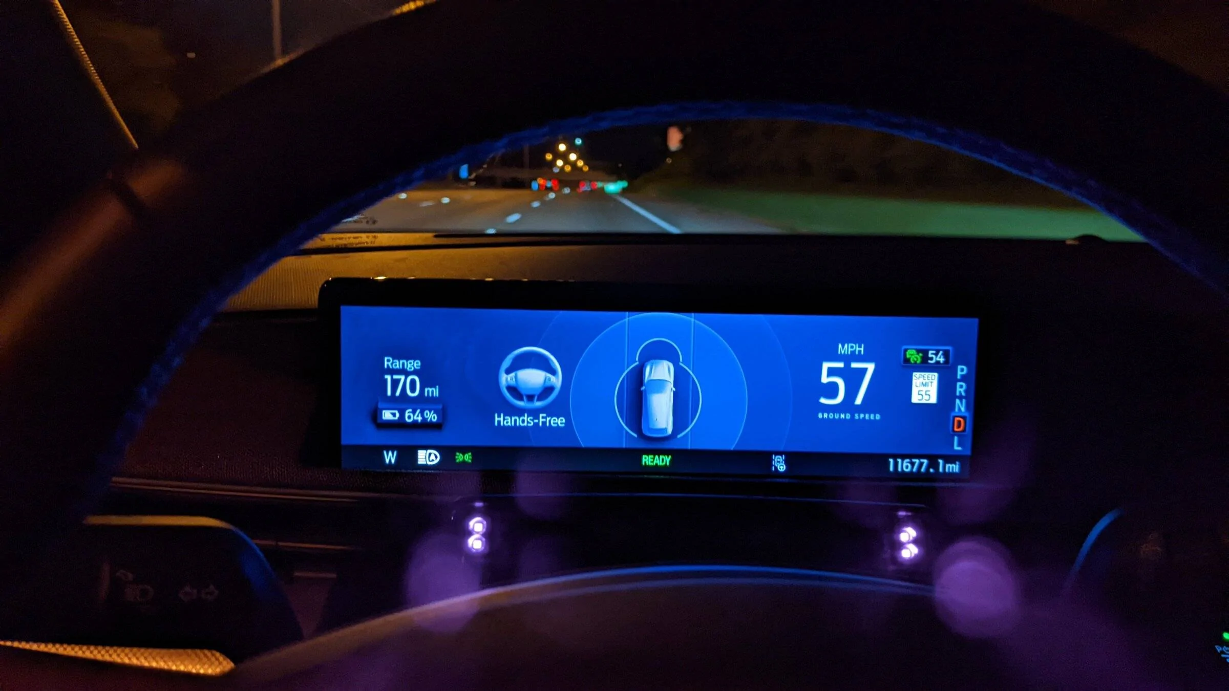

SUCCESS!
Ford Mustang Mach-E Optional Product Improvement Program 21G01 - BlueCruise Programming PXL_20220508_020043292
(Knowing my luck, I'll bet the OTA pushes to me tomorrow now that I've got it figured out.) As frustrating as this whole process has been, I really do think things have been changing/improving rapidly, as evidenced by the FDRS version upgrade, recent newer module updates etc. I got a Mongoose and FDRS license within days of the 21G01 announcement, but stalled out pretty early in the process. Every subsequent adjustment did push me a little further along, and with some help from people (Ford and otherwise) who reached out to me, I finally got it working. I'll bet if I had started from scratch now, I probably would have succeeded the first time around. Regardless, the Mongoose/FDRS also let me complete 21P22 which my dealer insisted they installed correctly :)rolleyes::rolleyes::rolleyes:)
Hopefully folks who have had their installs uh... stall with their dealers start seeing more and more successful completions...

So I've got FRDS set up, but there are no SW Updates listed. I did a PMI selecting no on the GWM, APIM, IPMA, and the TCU. So far, nothing has changed. I'm still at the sync revision 415 that the dealer left me at. No lane centering, and toggling lane keep while in CC shows "BlueCruise not Available" on the IPC. Any pointers from anyone?
Edit: It never prompts me to use my USB drive either.
PMI won't use the USB drive, that only applies if you need to actually update the software. PMI just skips that part because the software is current, the last step is it just re-writes the config from Ford to the module which is very quick and done over OBD.
I'd try it on the CMR, and CCM as well just to cover all the modules that are involved in BC activation.
You can PM me your VIN and I can take a look and see if I can see anything sticking out that you could try as well.

After a day of at home FRDS and with some help from members here (thanks!!) I was able to get my car unstuck and I just came back from my first BC drive!... which was to the dealership to tell them my car's all done.
ProximusAl
May 27, 2021
674
707
UK
Mach-E - SR-AWD - Star White
And what exactly was it that got it working? PMI on CMR, CCM?
