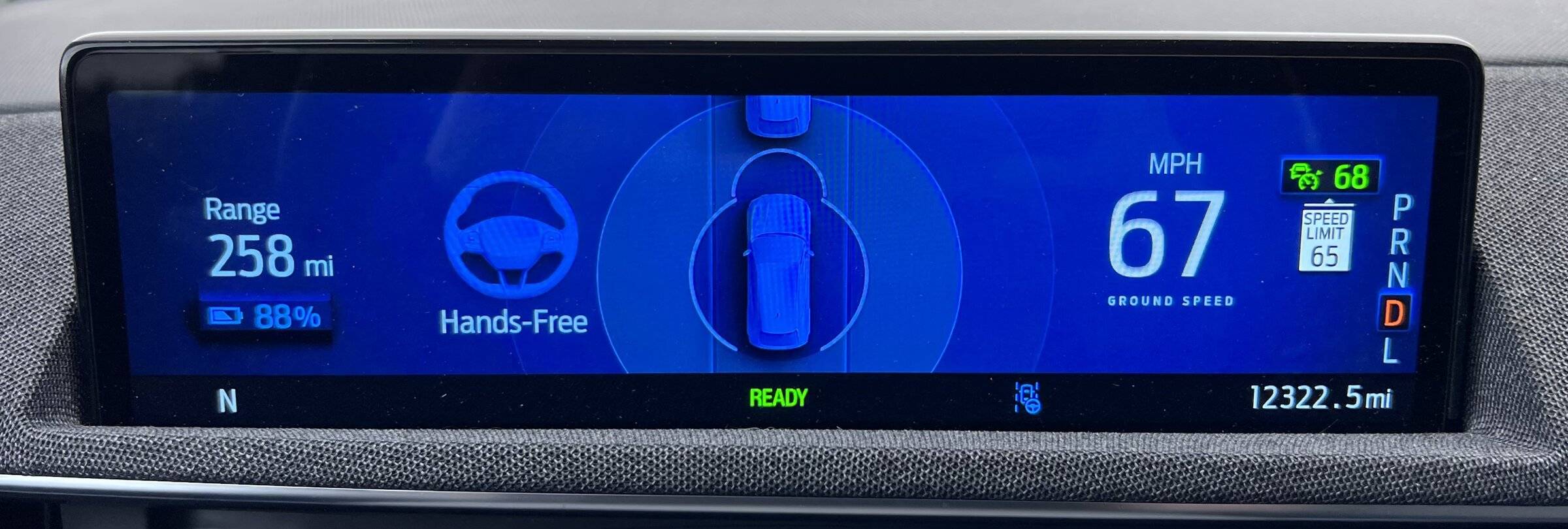

Ford Mustang Mach-E Optional Product Improvement Program 21G01 - BlueCruise Programming 123_1 (5)
Well, finally, after the fifth attempt by my dealer technician, I had a successful Blue Cruise installation. I won't rehash all the details from the first visit to the fifth, but I will say the dealer's service department stayed committed to getting it right even though it was frustrating, and he was very open to the feedback I provided him from this forum.
I did find something a little strange, though. A few days ago, I received Ford's email stating Blue Cruise was on its way for my vehicle. I was already scheduled for a Thursday morning appointment for the technician to make some new updates based on feedback from Ford Engineers. He was told to delete and reinstall FDRS to delete the cache and then reinstall the newly updated modules. Literally 5 minutes before they started the module updates on my car, I got a push notification on the Ford Pass app that Blue Cruise was now active on my Mach E. I immediately called the technician, and we both decided to go ahead with the module updates to get me to Sync 421. I was one of the folks who had Sync 364 and ACC and lane centering, but Blue Cruise was not active in Connected Services. I wonder if there was an OTA update installed right before the technician was to getting ready to install the newer module updates.
Anyhow, it works now and last night I enjoyed testing it out. For those still experiencing the headache and frustration with getting it installed, hang in there. I believe it is closer than you think. Thanks for all who provided me VIN updates.
Possibly, or possibly a lot of people working all hours of the day and night to get this fixed and you saw it live

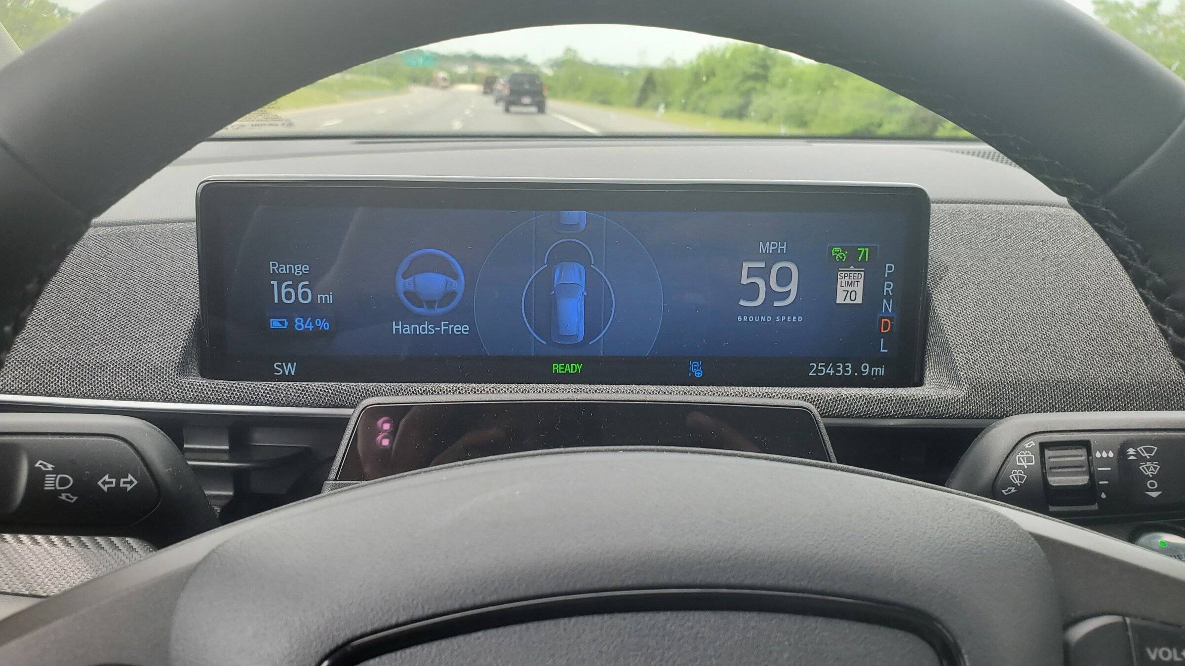

Another ray of hope for anyone else still waiting.
Had my car at the dealer for five days, they were having trouble at one point with connection and it kept failing on one module. Yesterday they finally got it all completed!
Sync version 421. Blue Cruise is working!
There is hope out there!
Ford Mustang Mach-E Optional Product Improvement Program 21G01 - BlueCruise Programming 367F5ED9-B2ED-4FF4-AB5A-93993874E618
