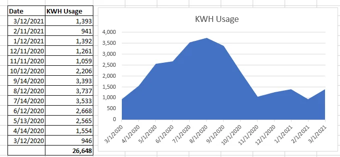

Question, I know the answer is "it depends on how often you drive the car and consume KWH from charging the EV" but Im trying to get an average/estimate kWH so I can figure out the additional electric costs per year e.g. a Swag amount?
My current usage for the past 13 months
Ford Mustang Mach-E EV impact on electric bill 1615839380835
For a larger house, the average size comes out to around 4,000 square feet and the average amount of energy consumed within a home this size is around 26,400 kWh/annual (this is inline with my house w 4 kids and a pool). For smaller homes around 2,000 square feet it would be around 15,900 kWh/annual
Im seeing about $0.14 USD per kWh that my electric company is charging me.
I read "Mach-E’s 84 MPGe, using 33.705 kilowatt-hours per gallon, converts to 2.49 miles per kwh"
Using that assumption, if I were to drive 20K miles in a given year + only using my home EVSE to charge my Mach E, I would add approx. $1,124 USD to my annual electric bill. By my calculations...
Ford Mustang Mach-E EV impact on electric bill 1615836616316
Did I do that calculation right?

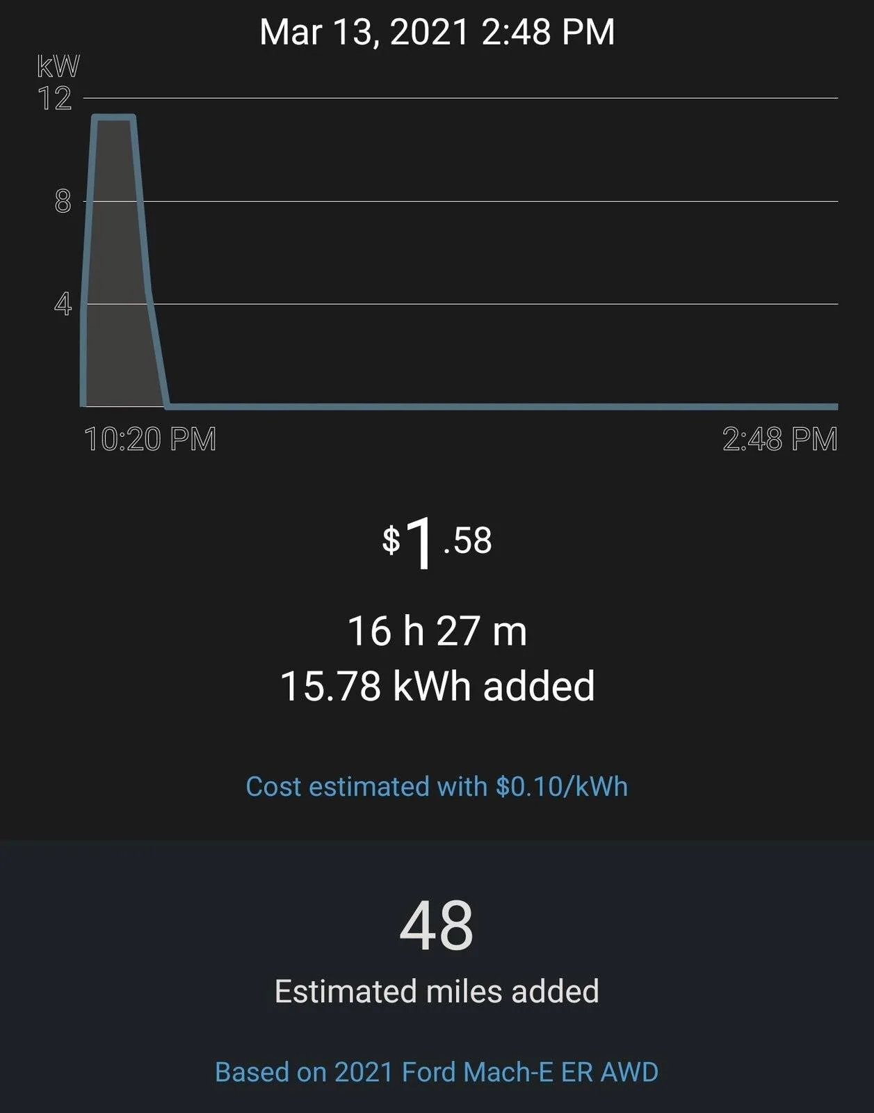

My electric provider charges rates between $0.09-$0.12/kwh depending on how much you use. The more you use, the lower it goes. So I have just been calculating my charging at $0.10/kwh. At that rate, a full charge of the battery will be just under $9. You also will have a little more due to what is lost to efficiency.
This is my charge after a typical daily commute to work and back.
Ford Mustang Mach-E EV impact on electric bill Screenshot_20210315-152253_ChargePoint
And this is a charge that went from around 5% to 100%
Ford Mustang Mach-E EV impact on electric bill Screenshot_20210315-152444_ChargePoint
