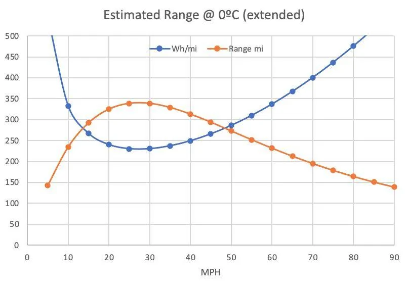

11,356
24,983
Ford Mustang Mach-E Heating impact on charge / range? Screen Shot 2021-11-15 at 9.29.43 PM
Here, I modeled the cold weather range the best I could. This assumes about 1.5 kW of heat being used to maintain the cabin temp.
As others have posted, the heater, if left on, will burn about 6 kW per hour driving. When I'm alone, I just use heated seats and wheel with the occasional defrost when windows fog. With people in the car (and assuming you don't want to freeze them out), just plan on an extra charging/bathroom break stop along the way.
It will use more like 1-2 kW/hr unless you are well below 0ºF. Heater doesn't stay at full output for long.
