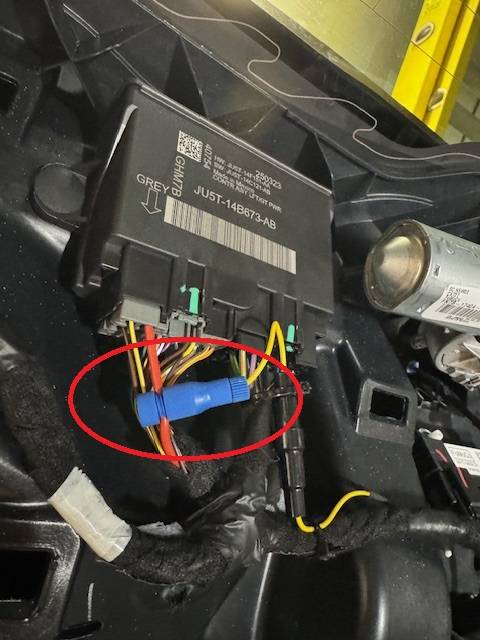

My car did not have the power connector shown in the video I had to tap 12v power from the liftgate module itself (black plastic ecu with 2 harness connectors). This is very easy as the module is on the right side of the liftgate not far from the hatch button. If you disconnect the liftgate module while tapping the liftgate/hatch will likely lose its position and stop working completely until you close it.

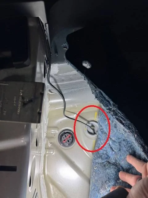

Don’t run the wire through the trunk floor as shown in the video. Drill a hole in the plug and replace to keep water/moisture out of the trunk and minimize the wire from rubbing on the sharp metal edge (see picture)
