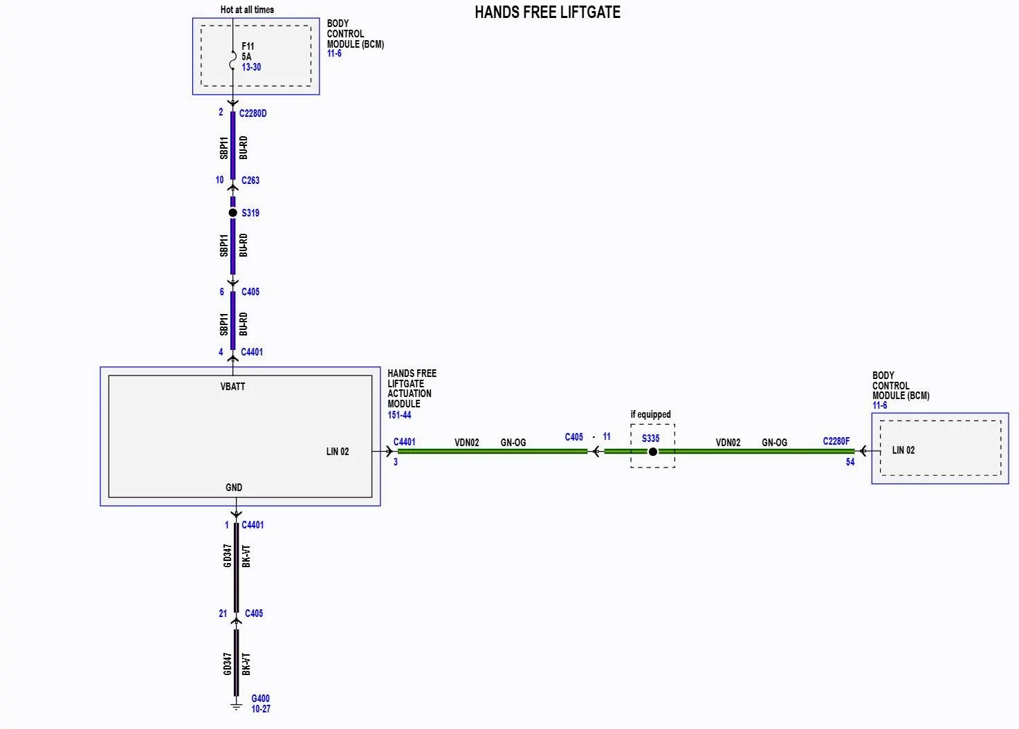

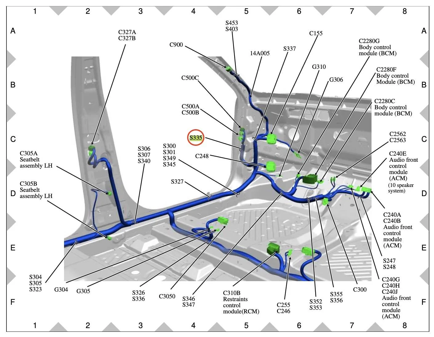

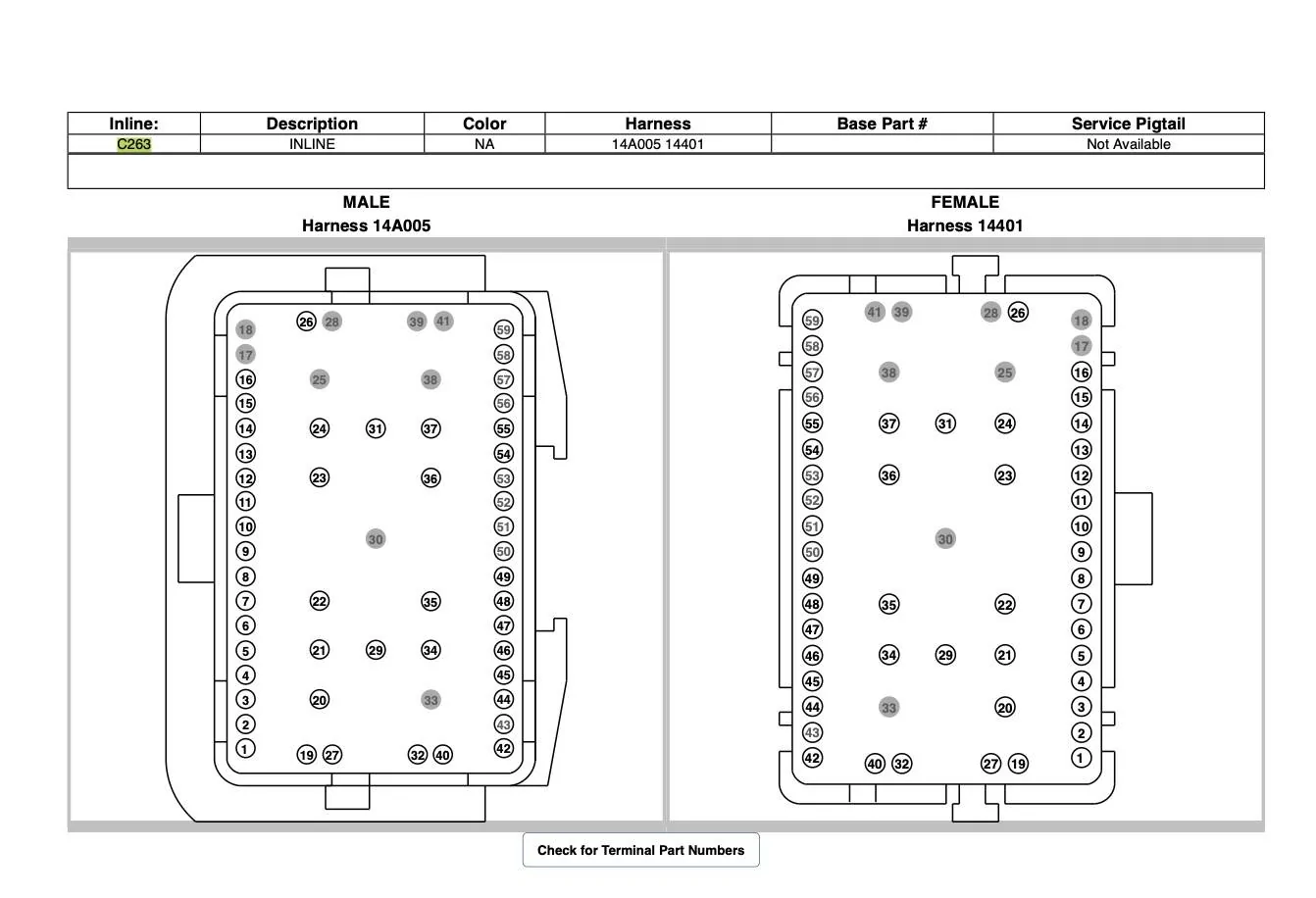

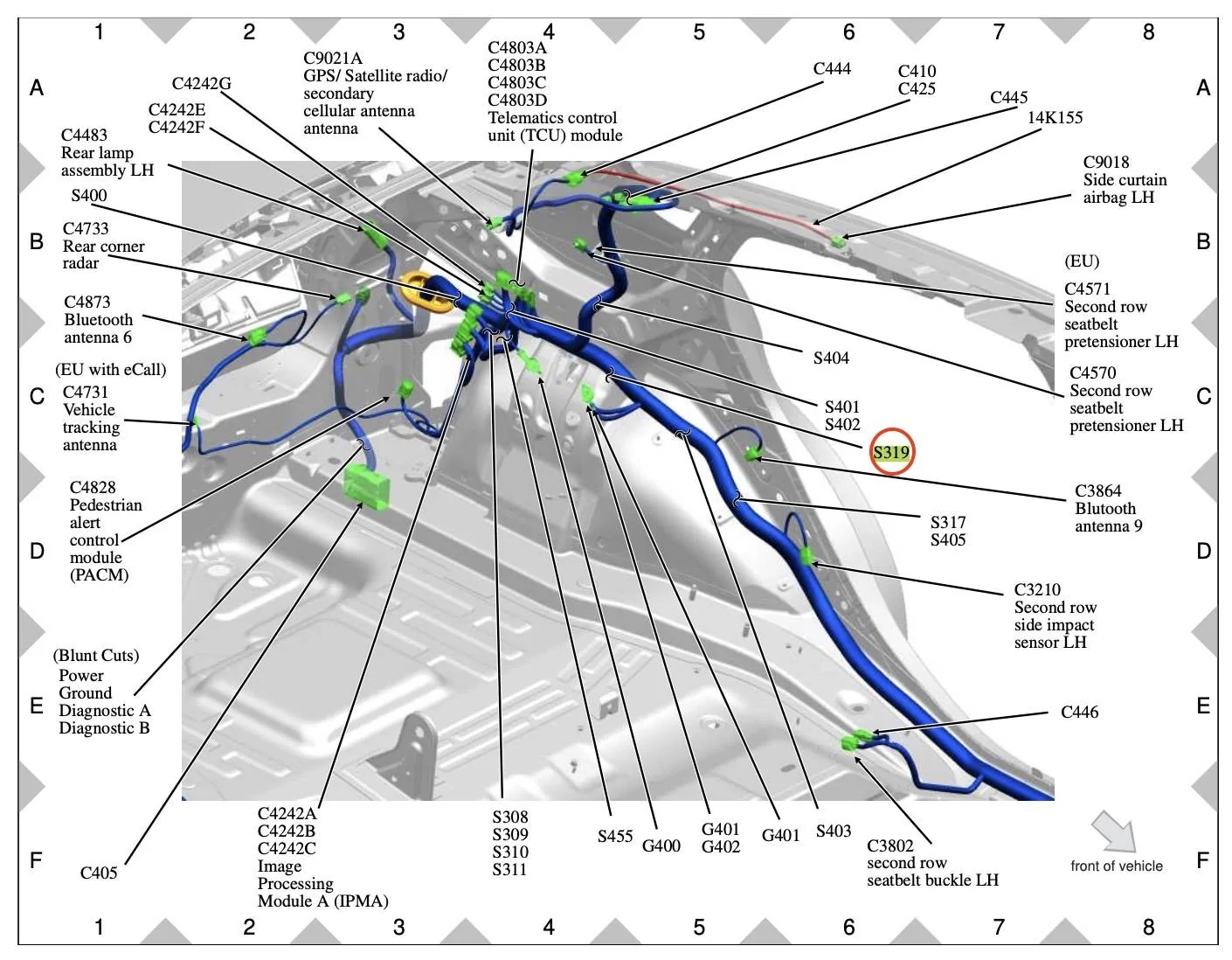

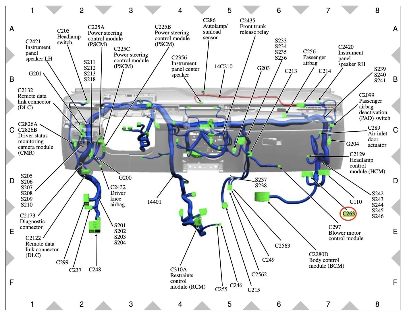

I'm installing a hands-free liftgate system and I'm looking for connectors.
Do you know where the C263 connector is (what the wire connector looks like) and where the S319 and S335 points are?

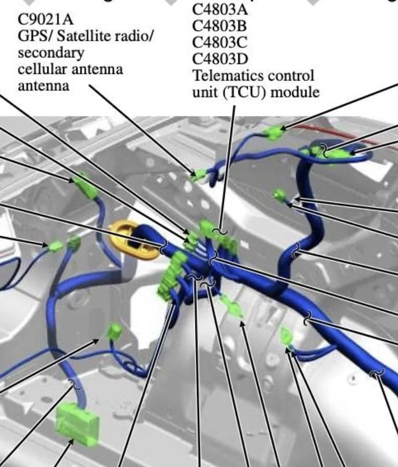

I'm still looking for a place where I can find a 12V power supply to power the liftgate module.
Can you check the 12V connection to the TCU?
I think that's where I'll have the closest constant 12V
I’m in a plane and can’t check anything until later today. Where are you wanting to pick up the 12V. In what area of the car?
