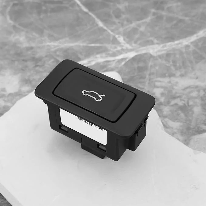

I wanted something that, when I was done with it, would look OEM enough not to cause problems at lease return time. I found this knockoff Audi-style button on Amazon:
Ford Mustang Mach-E Installed Physical Tailgate Release Button + Power Liftgate Close Button 612Cf+UMFcL._AC_SX679_
It blends in well enough, but the backlight is red, which doesn't match the ice blue on all the other buttons in the cabin. No matter since I'm going to replace the guts anyways.

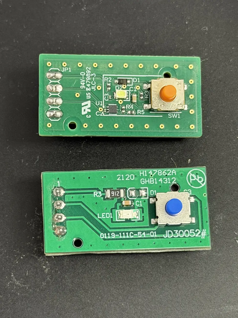

To achieve the 0.5 second delay, I designed and built a new circuit board to replace the one that came with the switch:
Ford Mustang Mach-E Installed Physical Tailgate Release Button + Power Liftgate Close Button 20251201_202948724_iOS
Original button on the bottom, new button on the top. For any microelectronics nerds reading, it's based around a comparator with an open-drain output and an internal 400mV reference. Pushing the button discharges an RC circuit until the voltage on the cap drops below the reference voltage and it pulls the output (in this case the liftgate button) to ground.

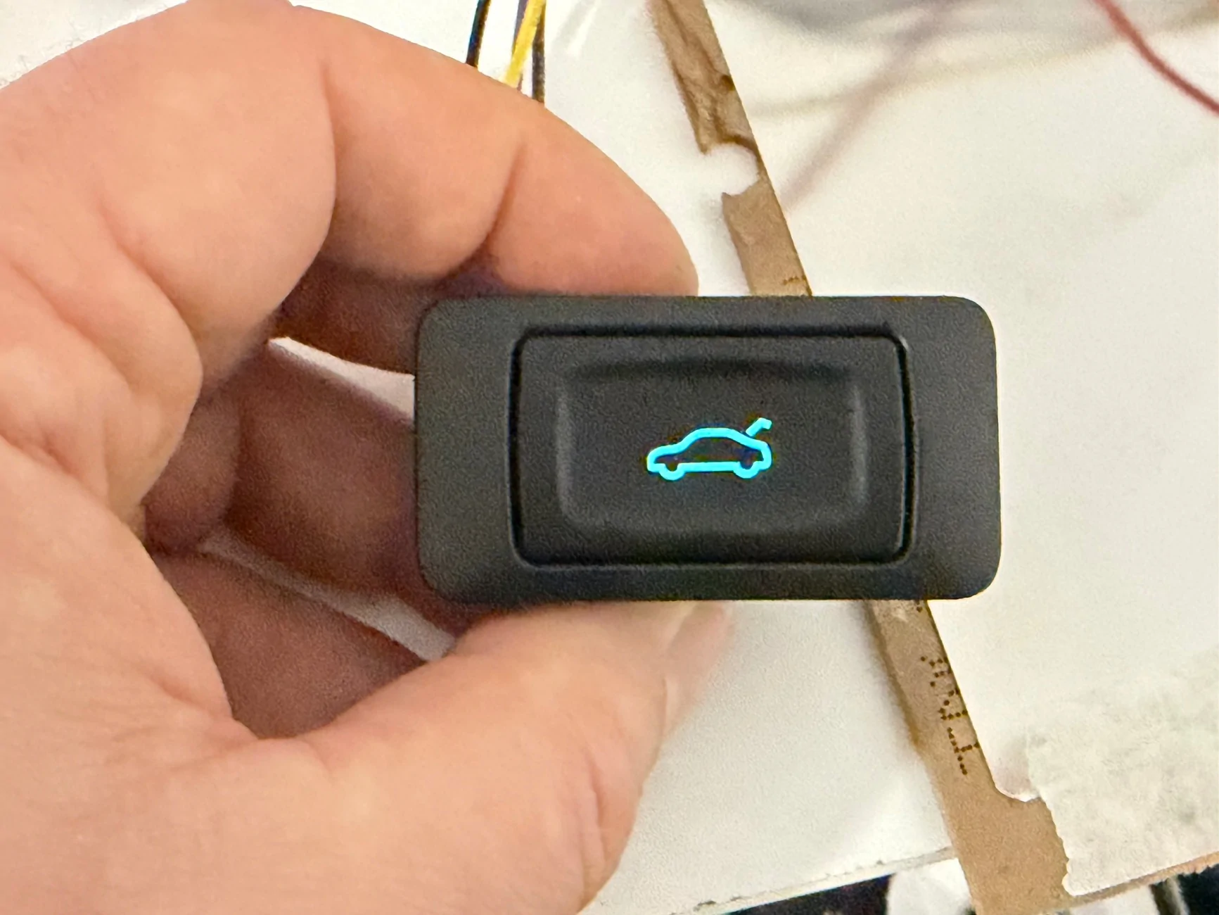

I also used a different LED that matches the Ford-standard ice blue lights. This one should blend in much better:

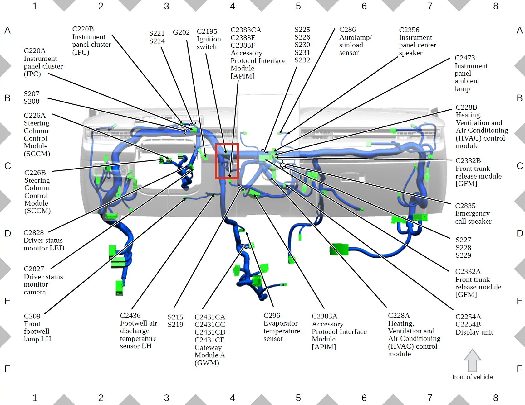

To hook it up, I need access to the PWM cluster illumination circuit from the BCM (the violet/gray wire). Most modules control their own illumination from the CAN bus. I ended up splicing into the harness for the start button. This also gave me access to a 12V circuit (fuse 11 on the blue-red wire), and a ground (black-blue wire):

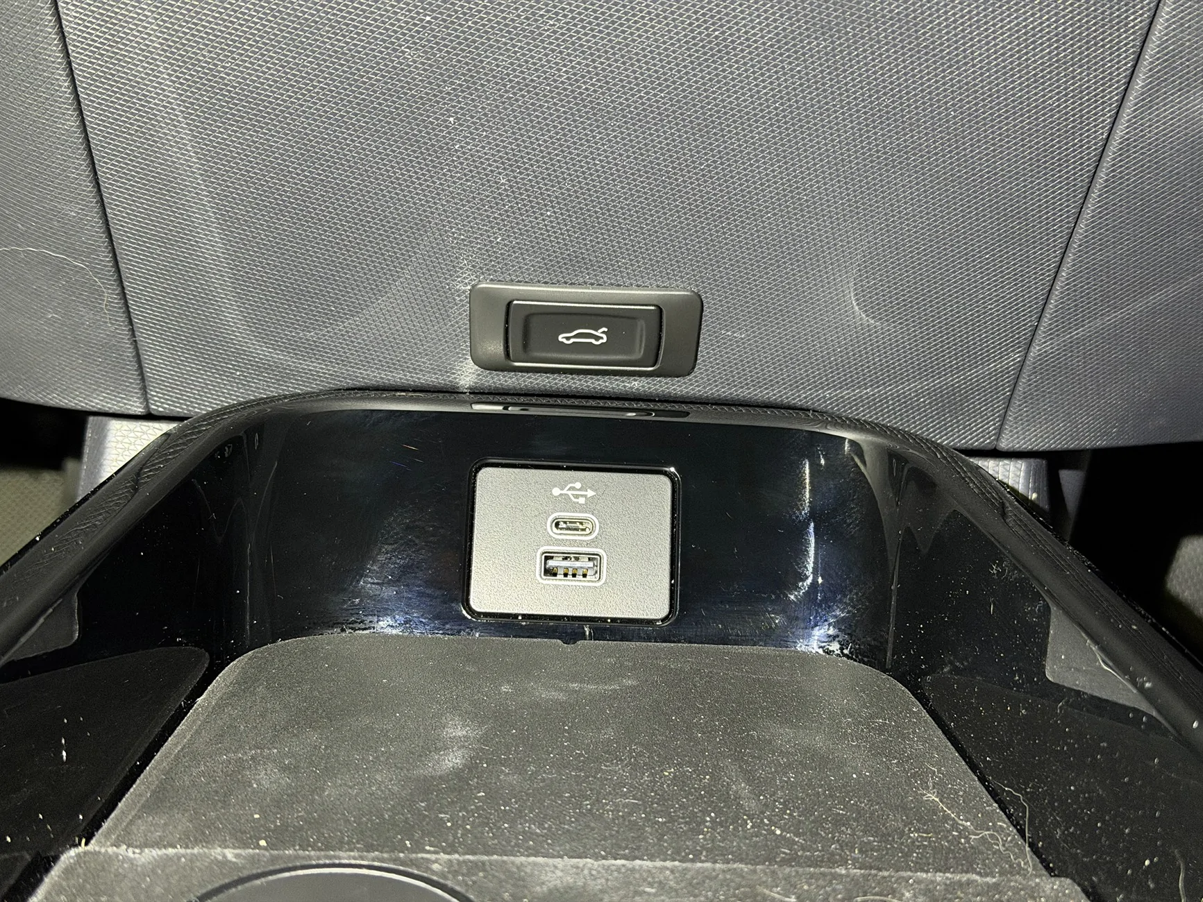

For the actual liftgate release, instead of snaking another wire through the headliner, I just spliced into the harness next to the BCM (brown wire off of the top connector C2280F). Coroplast tape and zip ties to keep everything connected and secure.
The biggest issue was figuring out where to put the button. My first thought was to put it right below the headlamp switch, but there isn't enough room behind the trim for the depth of the button. I thought about putting it at the bottom of that trim panel next to the frunk release, but I ended up settling on the panel right above the front USB ports in the centre console. This way my passenger has access to the switch too.
End result:

I was looking for a place on the console as well, but mine is a 2025 and the shifter has moved to the steering column. I toyed with putting it right behind the cupholder (there's a PWM LED wire near there for the parking/hazard switches), but I figured it would just take one good coffee spill to gum it up.
